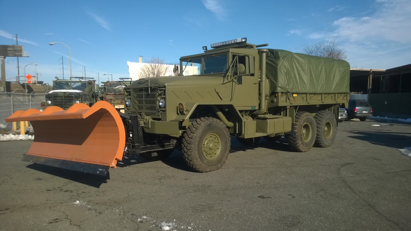

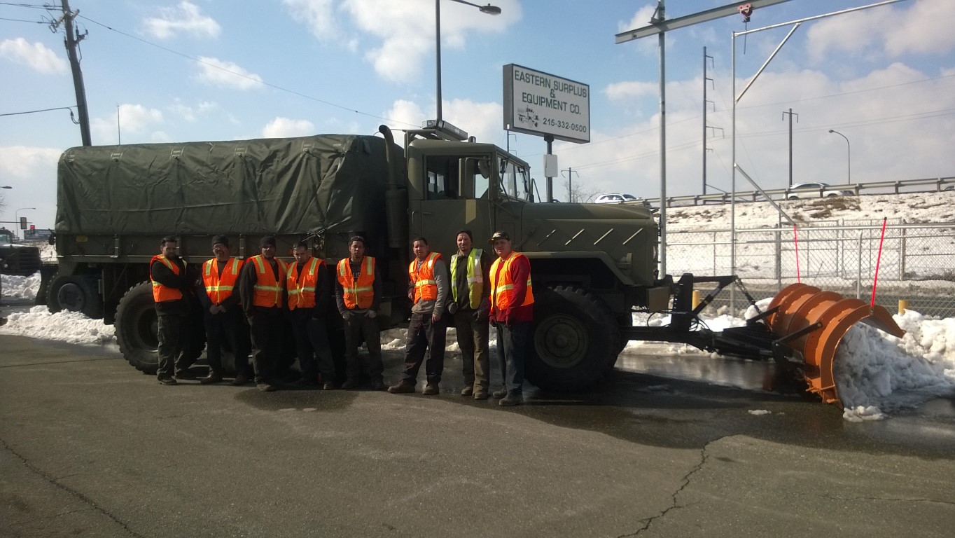

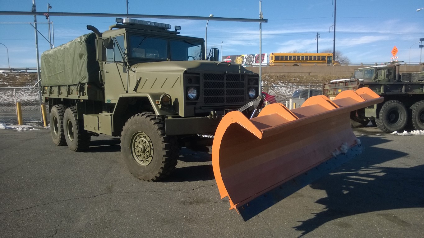

Eastern Surplus builds some nice rigs. I do not think they would mind
me posting up pics of there handy work. I look at this and I am imediatly
drawn to the HIGH ground clearance up front. So many times I see
these plow trucks w/ 6" or so of ground clearance and THAT does not
work for me. If this truck is still in service w/o issues I applaud
easterns designs;
(Pics to big to post, here are links to them)
