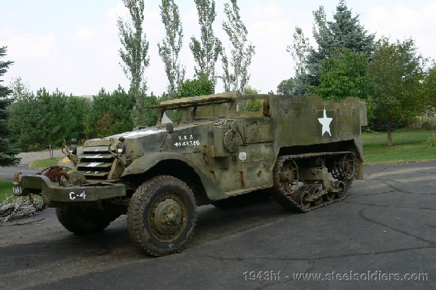

Track was found in the Horn of Africa, Djibouti desert... it had been driven out to the sand and abandoned by the French Foreign Legion in late 50’s or early 60’s ... French stated that they received the track from US in Korea in 1954 (Records confirmed that 4 M16A2’s and several M4s were transferred to the French in 1954 from US Army in Korea) and they took it to Indo-China (Vietnam). From Indo-China to Djibouti Africa in 1958 and used by the legion until she was driven into the sand and left ... I came across her while I was out with my team on a 6 miler one day .. Recognized her thru all the thorn bushes that had grown around her... worked with my French Liaison officers who were assigned to my shop and got permission (with a small fee) to recover her... The French considered the HT as a nuisance (go figure) there was a lot of ass-pain in recovering her (PAPERWORK/ CUSTOMS)... but all were overcome and her she sits... I owe a huge debt of gratitude to several fellow enthusiast working for Kellogg Brown and Root (KBR) Who volunteered their time and help to me in recovering her from the sand, bringing her back to my base and helping me to put her together again for shipment... these same folks helped me load and chain her into the 40 foot container for shipment back to US.
My intention is to show her in parades, at historical events (military/other) etc and I want children and adults to crawl all over her and get a feel for what it was like to fight and live out this beast by those who gave so much during WWII and Korea to defend our way of life. I intend to keep her in her current WWII paint. The tires are 1952 Michelin Invincible Combat Run Flats and are solid rubber... 1943 BFG tracks are in good shape and there appears to be no separation of the BFG rubber on the bogies... all the engine oil levels, fluids in the differentials etc were good.. Soaked the cylinders down and she turned over very nicely so then I did a compression check... 3 cylinders had lousy compression... figured that the valves were hanging-up and they were... 1 sparkplug was cracked and broken off in the head... decided to pull the head, drop the pan and yank the manifolds... the crank, cam, pistons etc look beautiful .. Head has cleaned up very nicely and to date I have rebuilt the carb, fuel pump, vacuum pump, generator, starter and distributor... Water pump is solid with no slop in the bearings, a buddy of mine went thru the radiator as the filler neck had some pinholes and there were two leaks in the core ... pulled both my gas tanks... One was sealed, had a cap... the other did not... they had some rust and dirt... rolled them up and down the hill a few times with some chain inside to knock all that crap loose then cleaned them out and red-koted them both .. I installed NOS sending units and reinstalled tanks. My current and next project is the wire harness (All 4 of them) dash board rebuild, master cylinder and the Maxon turret.

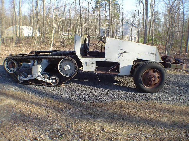

That has to be the coolest recovery ever of a halftrack! To me the Halftrack was the US icon vehicle of WW2. When looking to purchase one I could have never even dreamed of finding / affording one as complete as yours, well worth what ever $ and affort it cost you. We are doing ours the hard away, one piece at a time.
Picture of ours when purchased.
