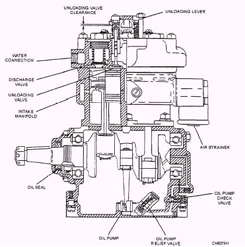

Maybe there's different different designs out there, but every single cylinder compressor I've seen had the unloader line running back to the air governor on the firewall. The connection where it goes is the hexagonal boss with the three vertical holes in it shown in the pic below. The center hole is usually threaded 1/4 MTP, for standard brass fittings and copper tube.
Could your compressor be missing something? Is that hole blocked off? I would think that a compressor constantly running at full output (safety valve blowing) would have a short life span.

See the 2, 7/8 inch or so bolt lookin' things to either side of the center raised housing? Those are the unloaders. They might be stuck in the loaded position, I believe that would be down. Dump all the air out of the system and take the caps off, careful, there's a spring under the caps. There's probably a bunch of goo or rust in there.

RE: Air compressor help
Accoridng to the above linked diagram, the big nuts cover the discharge valves. I pulled them off tonght. The forward one had a broken spring. I shimed the rest of the spring with some washers and tried to put it together. I don't think those caps are supposed to be removed without pulling the unloader tower first. They wouldn't go back on. I turned .020 off the outside edge of each on the lathe and put them back on. Fired up the engine and had air. Thanks for the help gentlemen. I don't have a pressure gauge or any gauge for that matter right now, but I could open the passenger side glad hand valve at the rear and had lots of pressure after a few minutes of running. I didn't before. Plus, the compressor sounds like a compressor now and the intake tries to suck my finger in which wasn't the case before.
I will pull a spring off my parts truck over the weekend and get rid of the washers.
