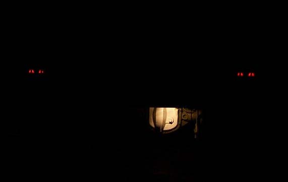

Of course this all goes out the window with convoy ops at night with out NVG's or before they were issued (say like WWII). The Blackout light on my Dingo has the hooded aperture and has a flap that allows a front facing aperture to be opened.
the British also illuminated the white painted rear differential on their vehicles with a lamp so the driver behind could see.
Like so
