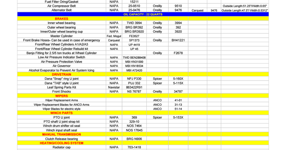

porkysplace
9,604
1,487
mid- michigan
The part numbers are bin the deuce parts spreadsheet ( at the bottom ) in the stickies of the deuce forum
