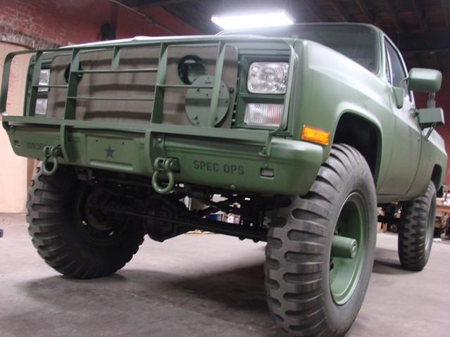

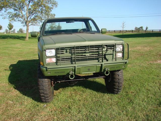

mikeV - I built those rims in 1985 and ran the same tire/wheel setup on a civi K30 4WD SRW for 10 years. When I decided to build my M1028, I planned to use the same tire/wheel.
The tires are 44" tall and there is hardly any rolling resistance. 1900 RPM @ 50 MPH with surprising power. I run 35 PSI for good road contact.
To clear the 44" tire height, I raised the truck 5" with springs and Zero-Rates from Off Road Design. The Zero-Rates provide for forward-backward relocation of the axles. I had to relocate the front axle 1" forward to clear the inner fender. And still had to trim the fenders to the maximum.
To balance the monsters, I used Balance Masters behind each wheel which automatically balances the entire wheel assembly via 40 ounces of Mercury at 15 MPH. The truck is smooth as silk at all speeds and rides better than my wife's Honda. I documented the entire rebuild in my rebuild thread (below).

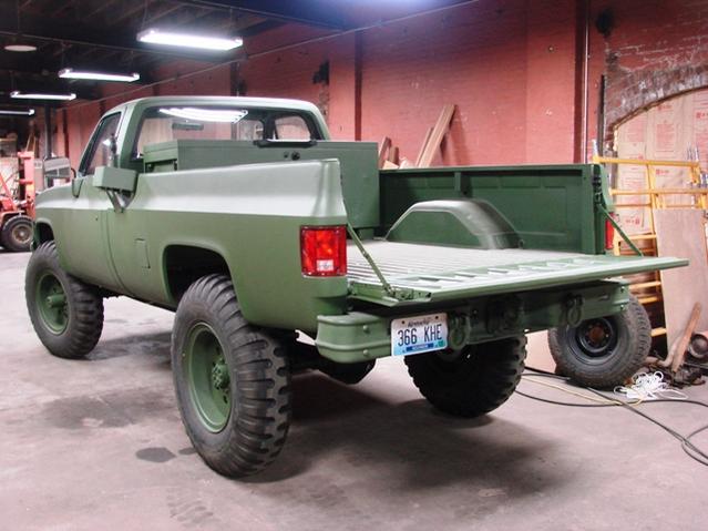

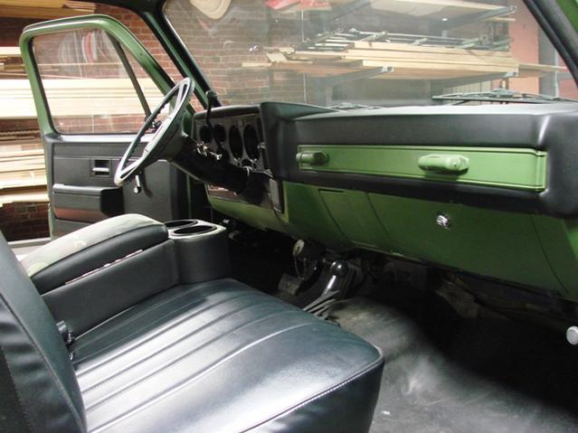

usmc80 - the seats are factory with new cushioning and black seat covers from LMC.
All sheet metal is original, with the exception of the hood, which is NOS. Please review my rebuild thread. The tailgate is original.
