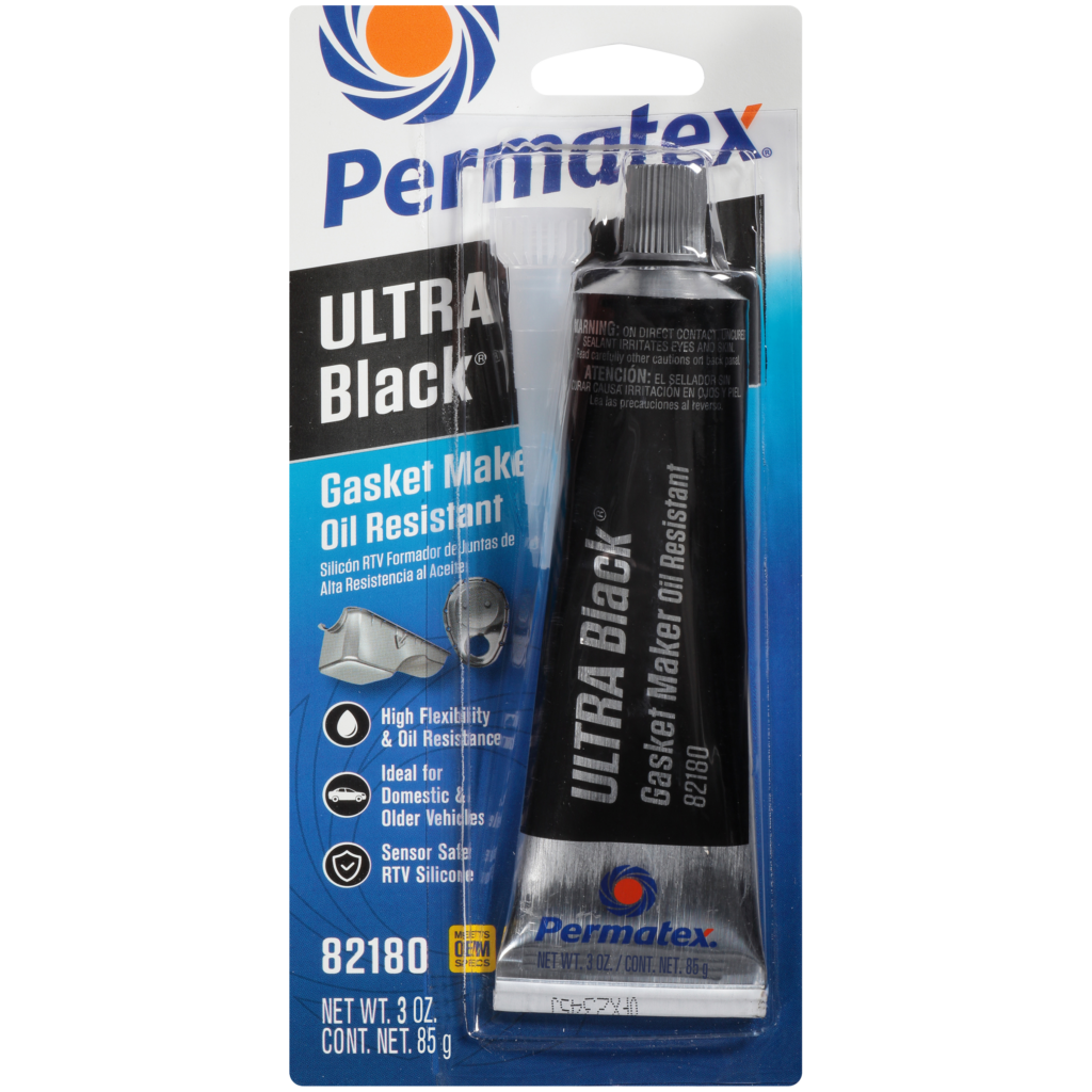

quick poll and looking for more insight into gasket maker material, and types. I am currently working on the geared hubs on the wheels. According to the TM, the gasket maker needed is an anaerobic (meaning it only cures in the absence of air), the differentials the TM called for RTV. Why the difference, both take Gear Oil? I used the black Permatex gasket maker especially made for Gear Oil on the differential covers. The red RTV that was used previously was "soaked" to describe it best, and it smeared when I rubbed my finger across it, that is why I looked up the Gear Oil gasket stuff.
Does anyone have a scientific reason for different gasket makers on the diff and geared hub? Could one use the black gasket maker instead of the anaerobic stuff?
Wanted to see what other have done, and the result.

For differentials and other applications with gear oil, Permatex makes a specific rtv, Others will work that are universal but worth getting this one. YMMV
Yea ,I saw that but this was more available and half the price....
I hope the black RTV is as good as the green you pointed out.
The anaerobic is normally used for machined surfaces and the RTV is for pressed (tin) surfaces
That is awesome information... That makes sense 'Geared hub, vs differential'. Thanks!

Just from my thining, Anerobic may be used in stressed areas. Such as the stearing knuckle. No give between surfaces, where as a rubberized sealant would have movement. This is mearly my deduction, but sounds good.

Anerobics allow adjustment of the parts, until they are clamped together. Most Anerobics are very poor at filling any large gaps. They are for machined surfaces as someone previously stated. RTV's (Room Temperature Vulcanizing) sealers can fill gaps, but start to cure as soon as exposed to air. If you apply RTV, and take a long break before assembling the parts, you may have to scrape it all off, and start over. Cured anerobics can usually be removed with the correct solvent. Cured RTV's usually need to be removed mechanically. As always, all parts must be absolutely clean prior to applying either sealer, or they will leak!

Use anaerobics anywhere you can. Silicone is very permeable and can seep oil. Silicone glues the parts together which makes disassembly difficult. Silicone is more difficult to clean up. Silicone contaminates surfaces for painting. Silicone makes chunks that can clog things up.
Anaerobics are not typically effective on sheet metal because they are not flat enough to exclude oxygen and may not cure.
Anaerobics are not as heat tolerant as silicones.

Can I use the normal gear oil silicone (black stuff) for the hubs? Thoughts?
I prefer the black silicone in most uses that are general engine or gear oil applications and not high heat. I've done mostly civilian mechanic work, but I have not had a problem with diffs and general engine use when using black. I picked up that habit from mechanics that have been doing it longer than I have, years ago. On my 6BT engine build I bought a full tube of the black stuff to use, and I'm following an engine builder that is far more savvy that myself for my first diesel engine.
Don't really have any experience with anaerobics, so I'm not what you could call an expert in the realm of sealants in greater detail.

...but you must think your labor has no value if you are willing to do the job twice...
And that is the main reason I started the topic, I agree 100%. Sort of a constant battle in my head when one side wants me to get the job done, the other screams just what you said.
I finished the two front hubs with the black gear oil resistant yesterday morning because that is what I had in the house, but am I fully content wit that decision? 'can't really say that I am. I hope it will work out, but if I have the slightest leak over the next few years, I'll re-do both with the anaerobic. That stuff is just not that readily available.
