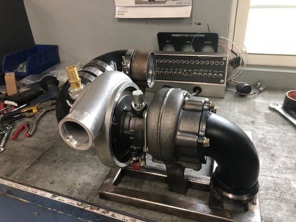

Maybe the following might be on interest to you:
I've decided to get this one myself for the 6.5 I'm going to put in my M1028. Looks like you can set and forget using the spring. If going with a GM-8 turbo look at Heath's Turbo-Master or Leroy's Turbo Spool Stick. Ordered Leroy's myself for my K1500.
