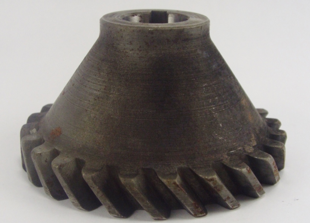

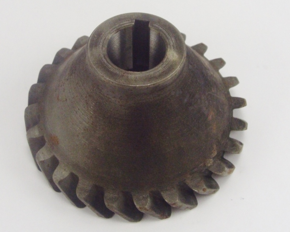

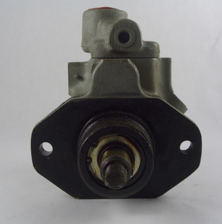

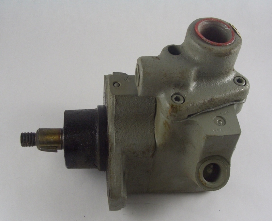

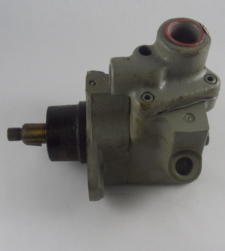

We now have New Old Stock 5 ton multifuel hydraulic power steering pumps and gears in stock
email or call
Dave Newman
Eastern Surplus & Equipment Co.
www.easternsurplus.net
Toll Free Office 855-332-0500
(5T-682) Gear for Power Steering Pump for 5Ton Multi fuel powered trucks. NOS. $195 each
(5T-681) Power Steering Pump for 5Ton Multi fuel powered trucks. NOS. NSN: 4320-00-075-3329, PN: 11640923. $225 each
