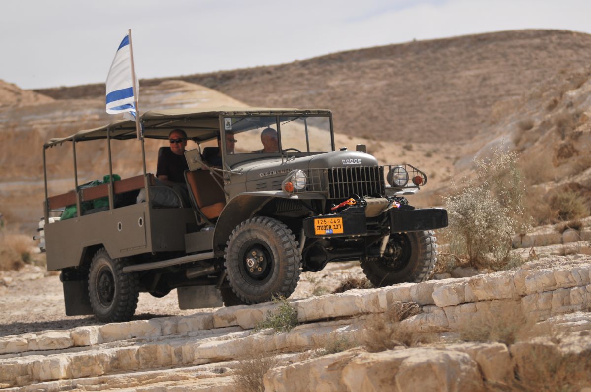

asafk
20
Israel
both looks too light.
look at this one, painted with the actual color used by the IDF since the early 70s:
http://www.jeepolog.com/forums/attachment.php?attachmentid=40172&d=1303086170
and bare in mind that the actual colors varies a lot. might be lighter or darker, might be more to the green or more to the brown...
I will try to get the accurate color definition.
this is one of the paints:
www.sigmarin.com/vault/documents/Microsoft Word - yellow.pdf
another local manufacturer is Tambur, and there are also some american manufacturers who knows this color, thanks to the fact that many HMMWVs, HEMTTs and others were factory painted to IDF definitions.
Thanks for the picture. That's the top layer color of mine but what I'm going for is the lighter shade from the 6 Day War. I posted this picture on the previous page but here it is again.

I made some calls, asked some friends. some were not sure, but the others all said that the color was the same as today, but the quality wasn't good so it faded really fast. an interesting point is that on the southern front, sometimes the standard paint was mixed to make it a bit lighter, but no formal lighter color.
hope that helps..
anyway, for the future, here is the "standard" IDF color spec:
L*=46.6
a*=2.0
b*=10.2
