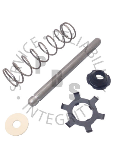

so I took your guys advice and am rebuilding the unit instead of buying new. The "disc" that goes at the base of the master cylinder pushrod is broken. The pirate jack rebuild kit comes with everything but that piece.
Does anyone know where to find one of those discs?
Any chance you could pop a pic of the part? I've got a few laying around.

these guys had it, and thankfully were local. its the white centering disc in the picture
