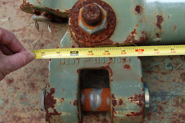

Here's pics

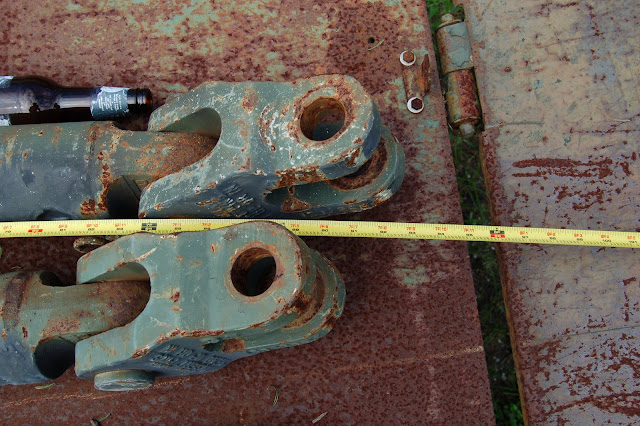

Huge one:
About 7 feet.

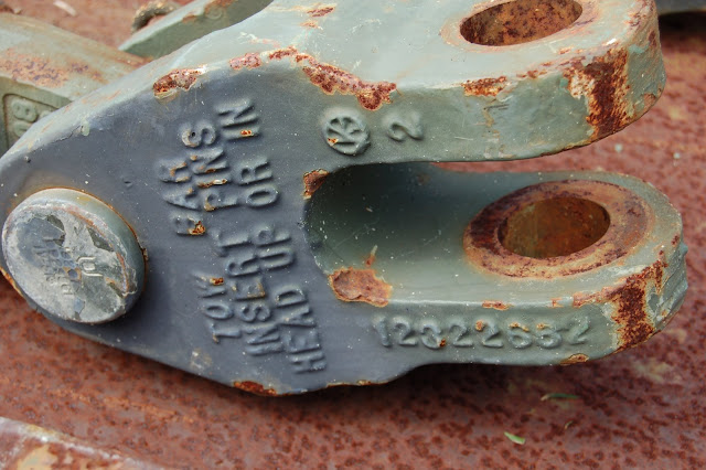

8383808 on the tow bar.
12322862 on the feet

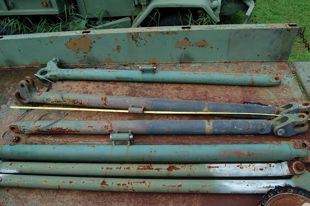

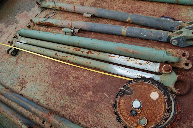

"Large" tow bar:
Also about 7 feet long.

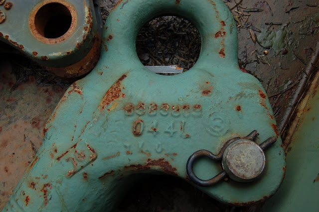

Number on the feet looks like: 19207 - 11660834

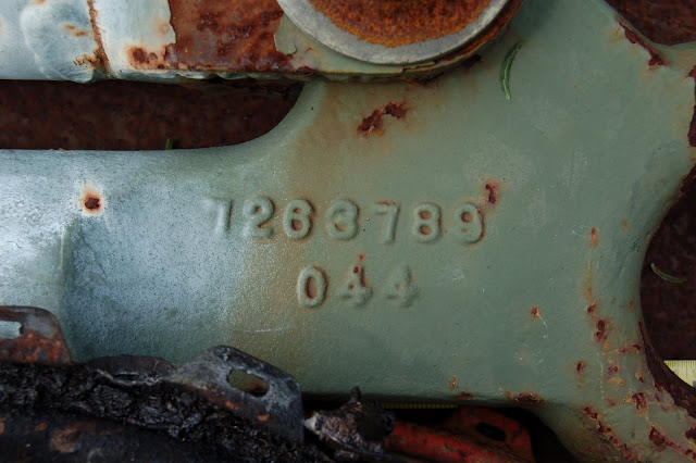

Number on the large bar looks like:
7263789
044
