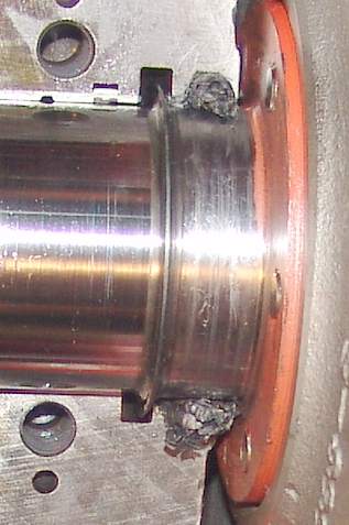

sounds like you have other issues,does the crankshaft surface have scratch or slash mark on it,with the rope seals on old motors, alot of them get this when some one uses a knife/screwdriver to force the rope seal in the groove in the motor half of the crankshaft seal area,and end up knicking/gouging the crankshaft journal,if it aint perfectly smooth,soon as it cranks this spot is rubbing the new seal and leaks start ,if you have to put another new seal,i would look at crank surface ,good luck to all on your projects :-D

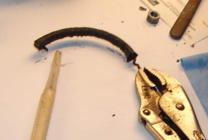

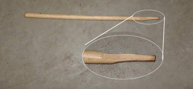

First, with the rear main cap removed, I needed to make a push stick to coax the NOS asbestos rope seal that was in there out. I tried cutting down a toothbrush handle, but it broke and as I was headed back into my wood shop to find something else, I passed my son's drumset and saw 100 or so busted drumsticks in pile. EUREKA! I took a drum stick to my band saw and carved the broken head end down to match the rear main seal pocket size:
Now armed with the pusher and a rope seal removal tool (a corkscrew) I removed the original NOS rope seal.
http://www.oldGMCtrucks.com/photos/gmcforum/302/TopSealRemover.jpg

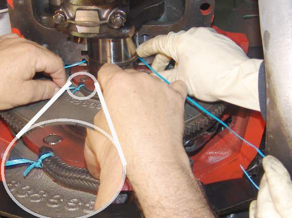

We thought we'd try to "sneak" the top half of this newer, thicker, denser, teflon/graphite rope seal up and over the main by fashioning a slip knot on a strong piece of nylon but after a great number of tries and loosening up ALL of the main caps, we could still not get it in. Getting the larger replacement seal in place on the top proved to be a much more difficult task. We tried a number of different approaches to feed it in, up, and over the crank but all just resulted in total frustration.
In the end, we removed the driveshaft and tranny and then with all four caps loosened a lot, the crank fell down a little and allowed us to finally feed the new seal in, up and over. The photo below shows the first (failed) attempt using a thick piece of plastic strapping. We ended up using double dental floss which was just strong enough to lasso the end of the seal, and while Bill's gloved hand tugged on the line, Mike fed it carefully to the slot with a small flat screwdriver while I turned the the engine over from the top by the fan belt/fan blade. This was absolutely a three man operation. NOT EASY!
http://www.oldGMCtrucks.com/photos/gmcforum/302/TopFeederSetup.jpg
http://www.oldGMCtrucks.com/photos/gmcforum/302/TopSealIn.jpg

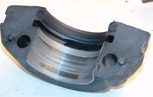

With the top seal now in place and using the drumstick/pusher, we kept mashing the proud ends of the seal into the pocket alternating on each side and with it now mashed in there as much as possible, we tightened up the bearing caps and trimmed it up using the best spacer and exacto knife which is included in the kit.
Now the focus shifted to the lower seal half in the bearing cap.

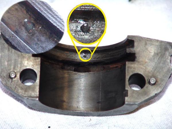

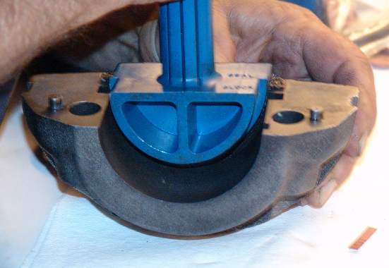

Because I find a lot of these seals have spun in the seal pocket and spinning in the pocket is obviously counter-productive to getting it to seal, I took the additional step of drilling a small pilot hole in the seal pocket and then driving cut brad nail into the hole to secure the seal from spinning.
http://www.oldgmctrucks.com/photos/gmcforum/302/RearMainCapPin.jpg
The tools that come with the BEST kit which include a small shim spacer that leaves "just the right amount" of seal showing are very handy. The rope seal is set into the pocket and compressed and mashed in place with the drumstick and round GM seal tool which duplicates the radius and diameter of the crankshaft surface that the seal will ride on.
http://www.oldGMCtrucks.com/photos/gmcforum/302/SealInstaller.jpg
http://www.oldGMCtrucks.com/photos/gmcforum/302/BottomSealInstall.jpg

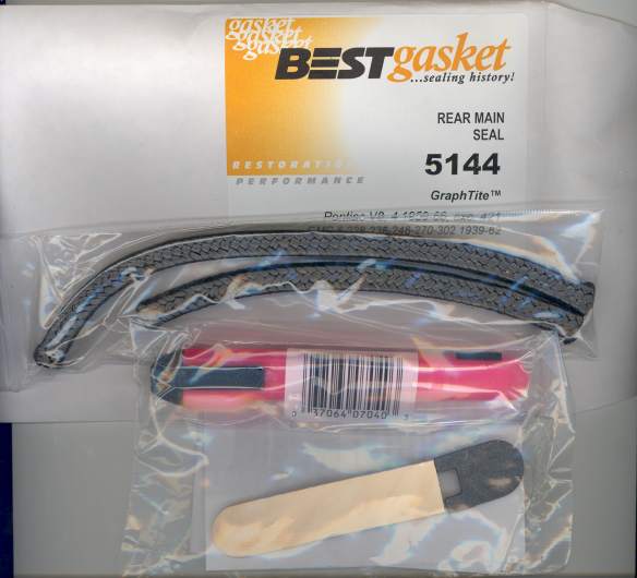

The kit number is 5144. Also, Best makes an EXCELLENT pan gasket and I highly recommend that too. Much better than the FelPro pan gasket.
http://www.oldgmctrucks.com/photos/gmcforum/BestGasketKit5144.jpg

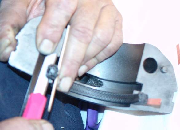

If you look in the photos above, you'll see a wooden "thumb protector" for trimming the seal ends and it is shown in my post "in use". Under the knife blade (included in the kit) is the black shim which is also shown as a round end on one end and recess on the other. The recess is fitted over the seal end while lying flat on the block or bearing cap, then the wooden thumb protector is used to cut against. The trimmed seal is shown in the final shot of the bearing cap.
