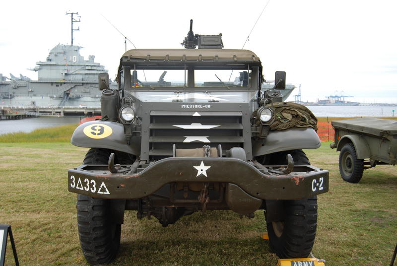

Not the correct recon unit, but this is a restored vehicle that was in the battle of the Bulge. I would assume other vehicles in Third Army would be marked in a similar fashion.
That's a 3rd Armored Division vehicle. 33rd Armored Regiment, C Company. Not sure of the purpose though. C2 might be the XO or someone else in the company headquarters. Not sure of the WWII bumper admin numbers. Today 6 means the commander, 5 xo, 7 is 1st sergeant, 1 2 3 platoons. 16 is the first platoon leader. These numbers don't apply to WWII though.
