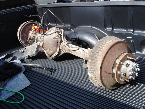

AJMBLAZER
2,688
Paducah, KY
http://www.supermotors.net/getfile/496420/fullsize/055.jpg
Notice the big hub sticking out inside of the "circle" of the wheel studs? If it has that it's a FF. If it doesn't have it then it's a SF.
Also go read that Pirate 4x4 thread linked earlier as it will show you the difference in the shape of the 14FF and 14SF diffs/covers. There's a VERY big visual difference between these axles. It's hard to mistake them for each other.

Here's some more photos to help add some more tech to a pretty good thread. Pics always help when you are searching junkyard stuff.
Dana 60 front (for M1008 )
As has been said, they are nice, and very heavy duty but carry a high price tag.
14 bolt FF rear from M1008 (just like what AJMBlazer posted)
Junkyard 14 bolts are cheaper if you are going to re-gear it anyway.
