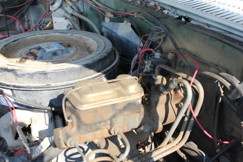

Picked up my first M1009 project truck. Hope to have it up and running by tomorrow afternoon. ;)
Thanks to 86m1028 for all his help yesterday. He helped tow it home and gave me some info on the truck. It's going to be a lot of work, but hope it will be worth it...one day.

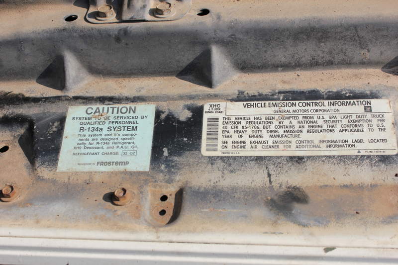

I sure hope the AC works as planned!! Now, I just need to determine if it is all 12v or is still a 24v machine, then buy batteries, and see if I can get her to turn over...oh....I need a new steering column and key first! :)

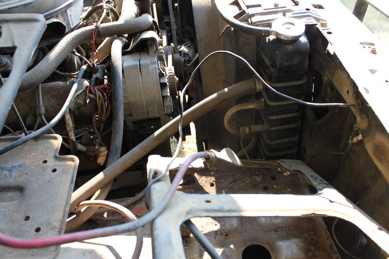

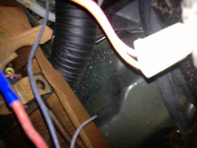

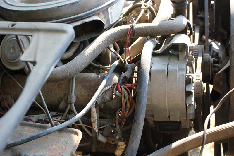

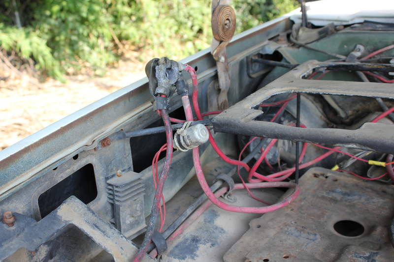

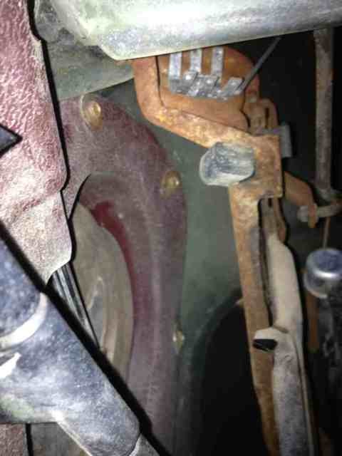

I know I am late on this but....

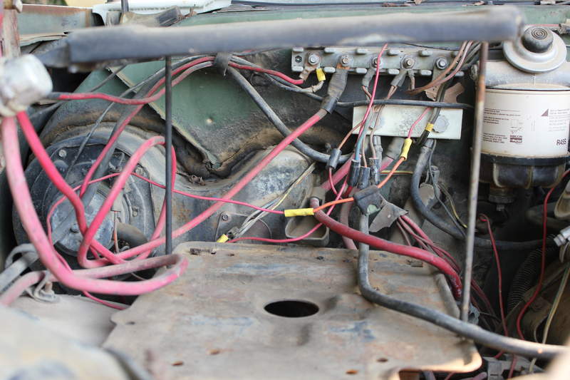

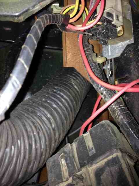

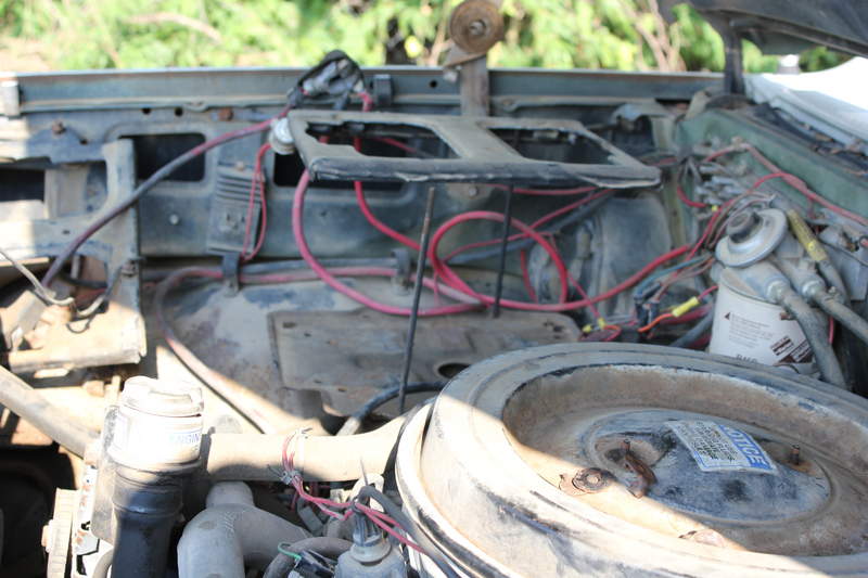

As I noted it is likely converted to 12v and I already see a problem from those pictures (#2 & #3). The glow plug resistor bank that is behind the engine on the fire wall appears to be hooked up. If it is you will only be getting 6v at the glow plugs and the truck will not start well or at all if it is cold out. With this current summer heat it may start, but likely not. I had the exact same issue with a M1010 I bought from Benbrook PD where they still have the resistor connected. After I correctly hooked it up to the battery for 12v, truck started. Who ever did the conversion did not understand how the system works or the resistor would have been bypassed.
There are also wiring for the emergency lighting, that flasher is probably for the headlights in pic #7 where you can see it centered. Seems to be a wiring mess from an incorrect 12v conversion, so that Roscommon article should help allot.
I just saw this and you may have already took care of this from my last post, but wanted to share what I saw for everyone.

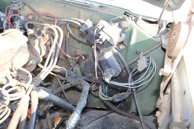

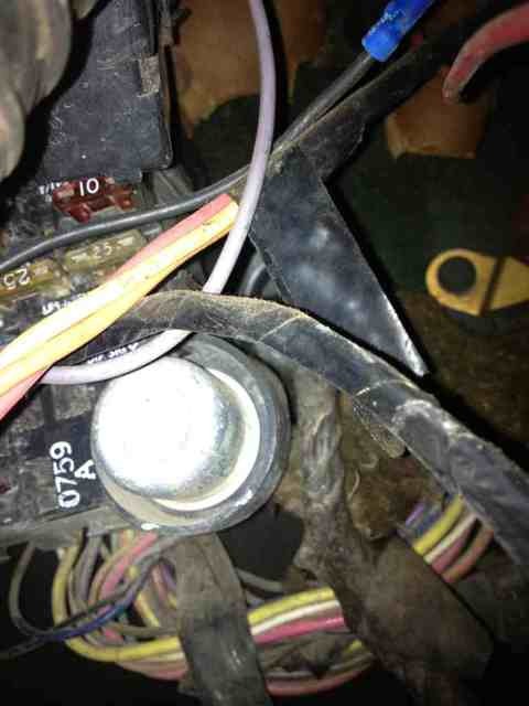

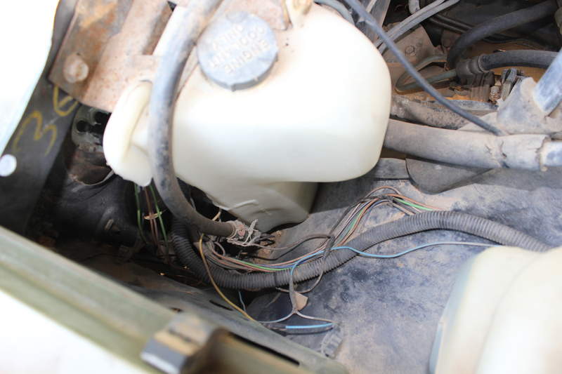

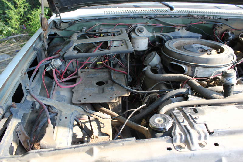

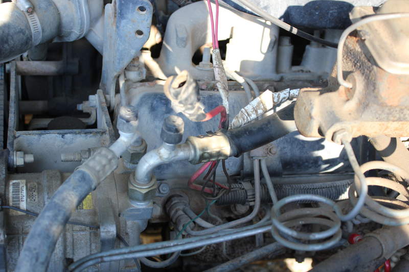

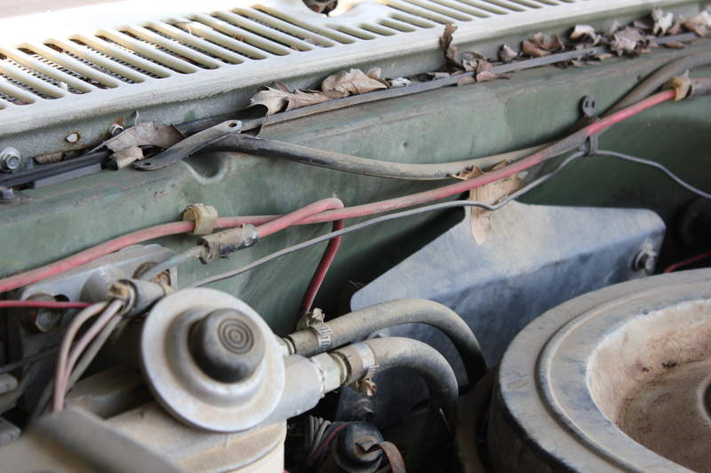

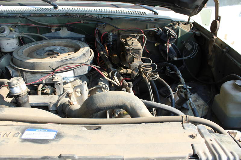

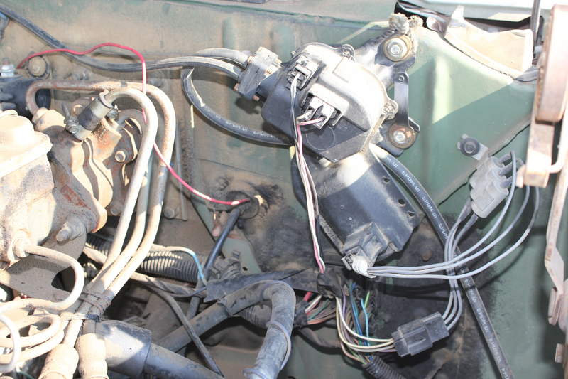

More pics of wiring mess
here are more pics of the engine area and the area where the Doghead mod will go, I believe.

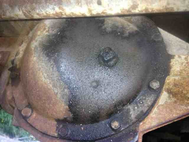

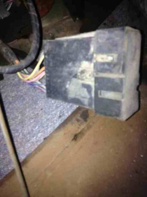

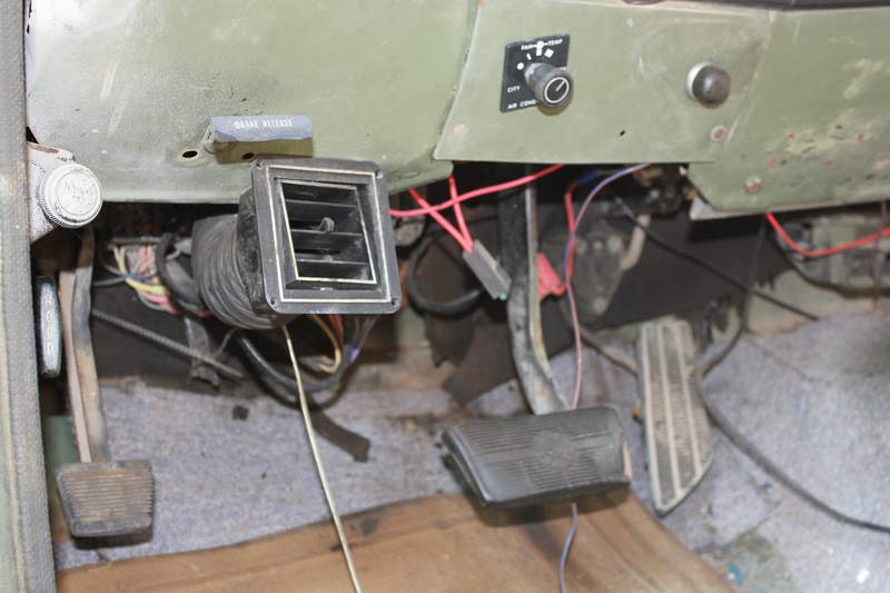

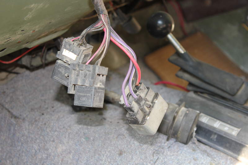

OK, I see a manual Glow plug (GP) button most likely in Pic #4 next to what is the A/C dial? So they new the truck was not starting and put in a manual button, hopefully that was done correctly or in a correct working manner. Under the dash do you see the large box near the parking brake or maybe hanging. Inside that should be square a circuit board, that is the GP controller. If it is missing you will have to continue to use the manual button. If it is there, running 12v to the relay on the firewall should allow the native GP system to work.
In pic #3 I can see the wiring from removing the alternator for 12v power side of the 24v system. My best guess is those two wires running from that side over to the passenger side are for 12v power from the original wiring. Hard to tell, but that is my guess and something you should correct going by the Roscommon system.
