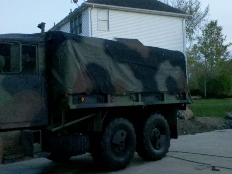

My M35a3 came with "extended height bows" ? for the cargo
it was a little tall for the appeal so iI decided to take the middle side panels out and just use the bows
these are 1 piece bows that might set lower than nomal (6-8 in above cab roof (they do have a v pitch to them) seems more than other bows?
any body got a measurement from the middle of the bow to the floor?
here is a pick at the lot and with my new cover
do these wrinkles work out or is this to looose?
it is a GMA cover
I got a Spare new one for $500 if you want
I called and they wanted 725 for 1
and 1000 for 2???????
thanks
Mark

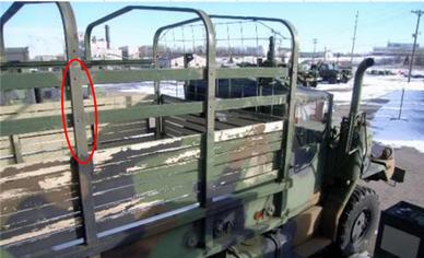

does you Bows slide in about 2-3 inches? fig A
if so do you pin them? with a bolt ?
front to back fig B or in/out fig c?
thx

The part that slides in to the troop seats/racks is the stave(the up right). My staves are metal as are the bows. Yes the stave goes into the bow about 3 inches. I have not pinned them or bolted them in. I do have the little holes to do so, but have not. Never had an issue with them staying in place.
