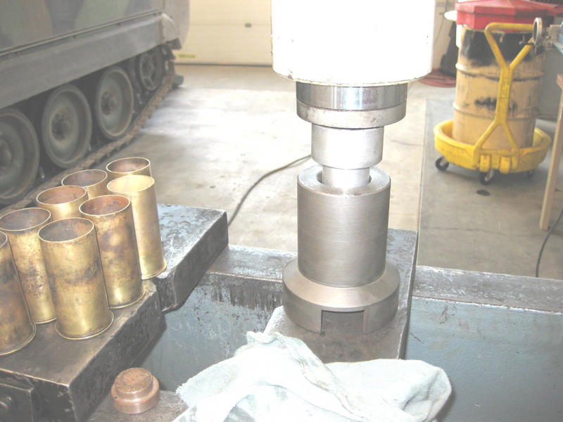

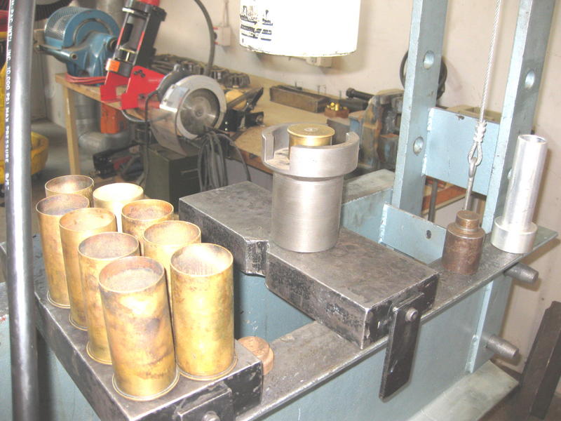

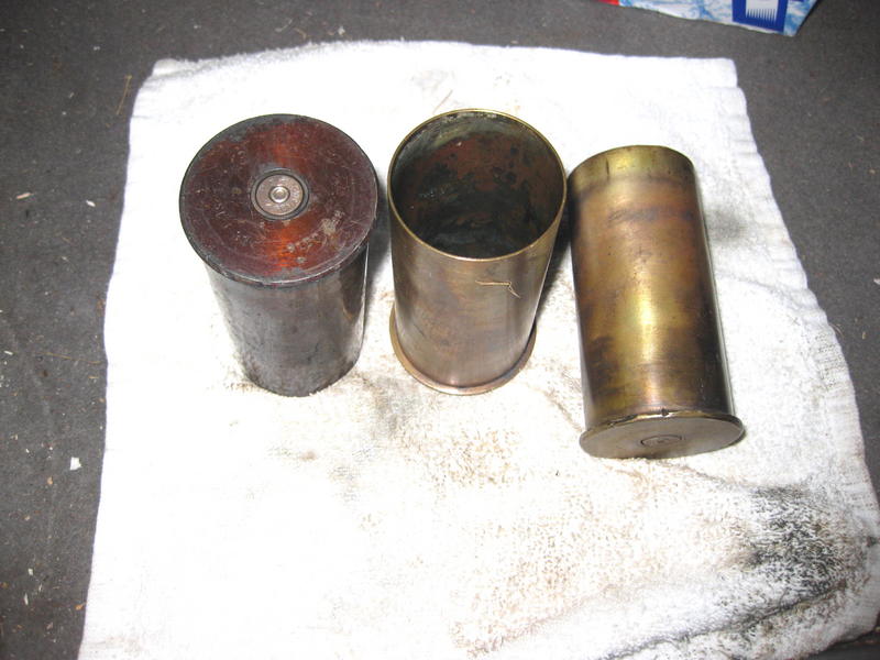

M3A1 Stuart Blank Case
Hello,
The shell case is an original 37MM M16 shell casing that has been cut down to 4 inches tall. All the blank cases I have made up were 37MM cases that were made in lamps or damaged beyond repair. I made up a bushing to accept a 44 mag. shell case for the primer. I use 1/4 lb. of Pyrodex.
