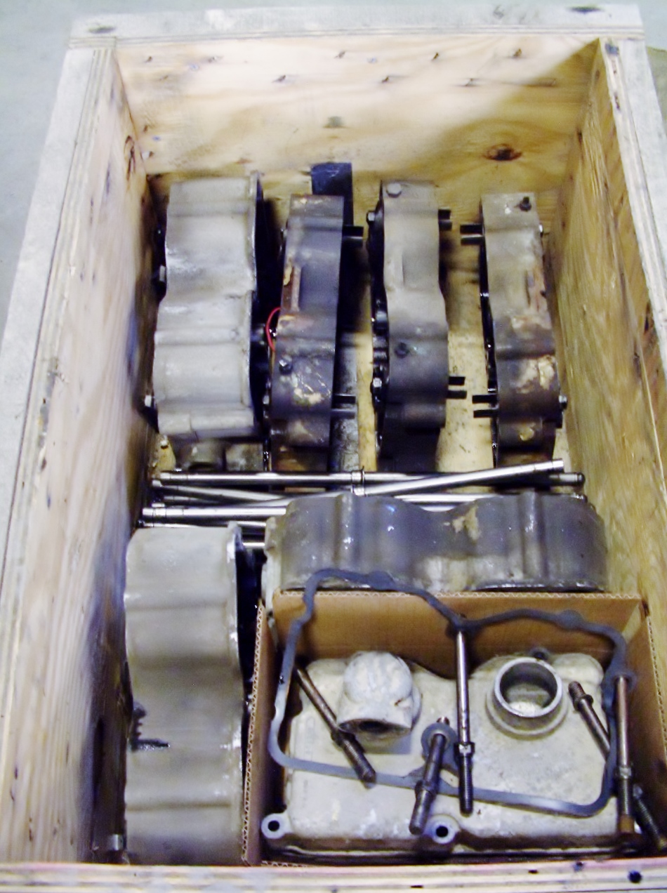

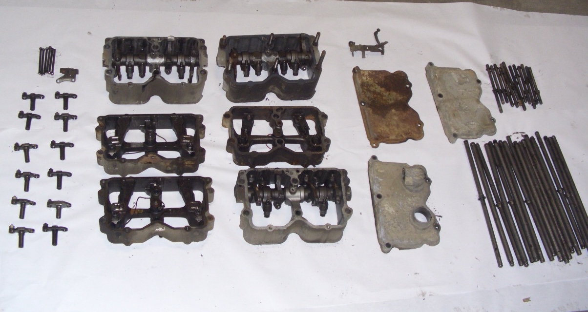

An exhaust brake will work fine on a M939, check out the TM, as it is an optional installed component.
WillWagner
8,479
2,610
Monrovia, Ca.
This will work, Jacobs used to offer a set up like this, but technology is making this type of brake obsolete. You install a sender in the lock up port of the trans so the brake only works when the trans is in lock up. Still need to install a throttle switch. They work OK. They work better if the 60 psi exhaust valve springs are installed. Easy way to tell if the engine has the HD springs is to look at them and see if you can see a blue stripe and the springs are barreled, wider in the middle than at the top and bottom. I think I still have a lock up switch from Jacobs somewhere if someone wants a p/n. IIRC, all C's were built with the HD springs after 1994.
http://www.pacbrake.com/index.php?page=specifics-6
