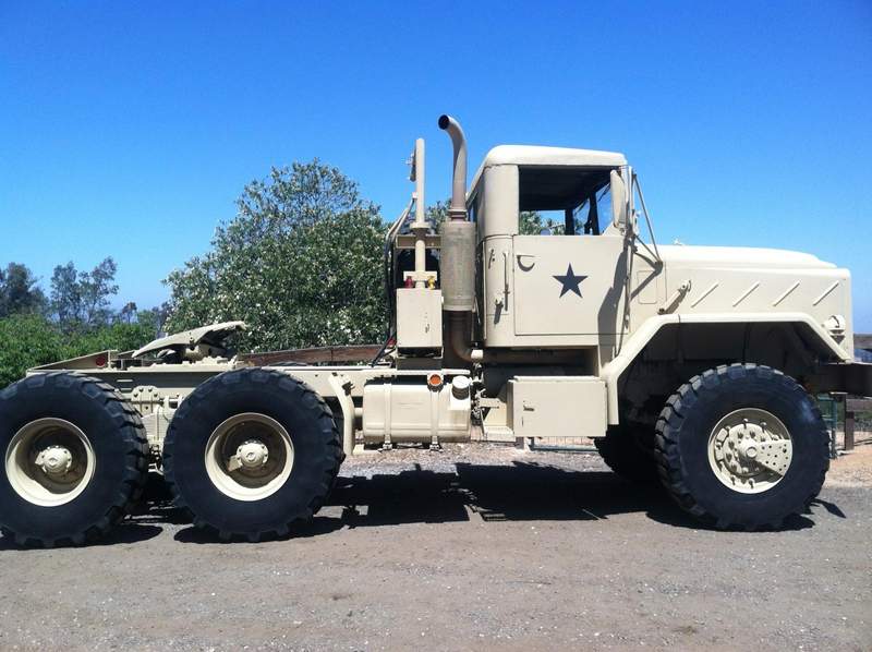

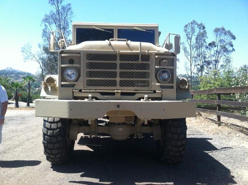

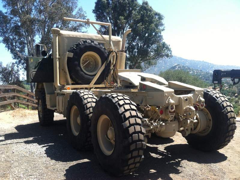

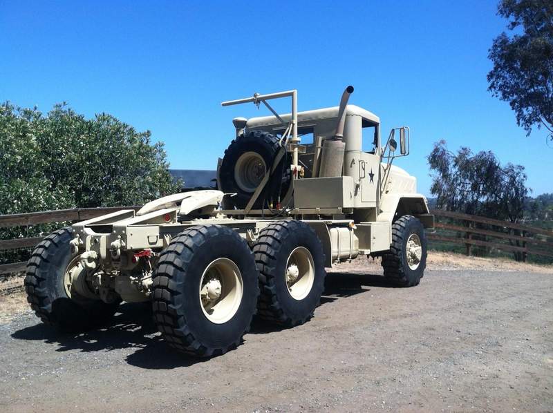

Found this over the weekend and brought it home today. Truck is clean in and out! Runs like brand new too! We have hopes of putting it to work out here in California but I am weary of these CARB laws.
Would be great to find a lowboy to go with it!
Anyhow, in the mean time I thought I would share some photos.

The truck is sharp! When you talk about putting it to work, I always wondered how much weight DOT will allow on thoes singles, for highway service. What the tire is rated for, versus what DOT allows, I suspect are different, not to mention what Uncle Sam rated it for. I understand that it is 550# per inch of tire width, time the number of tires per axle. You might want to check.

I am not sure on the # for the singles either. I will check tomorrow on the tire rating and be sure to reply with an answer. Couldn't believe how clean the truck really is when I saw it for the first time. Zero leaks. New motor. Complete overhaul. It even came with all the documentation from when the work was done.

With the singles on it you will either need a military trailer or a custom trailer so that the deck sits low and level. You might also have to out a civilian sliding fifth wheel on it for weight distribution and height. If the deck is not low and level certain equipment will end up being over height.

Awesome looking truck. Good luck with it! Are you planning to haul a low boy on the road, or off-road? I ask this because I don't think you are going to like the truck when trying to tow a lowboy (probably weighing in the 20K pounds range) and a load. These trucks just don't have enough power. If you need to haul a lowboy on the highway, I suggest finding an M915A1.
