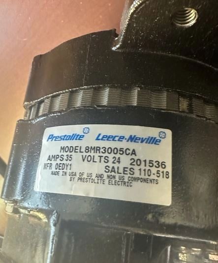

Does anyone know what would be a reasonably sized battery charger that would work in the event of an alternator failure?
if I am reading the TM correctly, the fuse is 30A but I am assuming the actual draw would be far less than that. Would the 2x2A @12V mentioned above keep up with the draw under load?

I don't think the 2x2 would suffice. Your fuel pumps and Fuel solenoid will probably draw more than that and slowly deplete the batteries, not to mention the need to recharge the batteries from the start up draw.
I'm sure someone had done a load test on the DC system and can post the typical draw on the DC side.

I believe the regulator on these alternators is rated at 4A, so if you use a NOCO 5A x 2 Bank unit... it should suffice to keep the machine along in a dead alternator situation
That doesn't seem right... The Alternator is a 35 or 40A alternator with a 30A fuse at F1 and the ammeter will usually be up in the +20A range briefly after starting the unit.
I think the 5X2 Noco would probably be sufficient as opposed to the 2x2 but I don't think the charging system is 4A, unless I misunderstand what you meant!

I'm curious about the 4A number on the regulator, as doesn't the TM call out the original Prestolite as either 8EM3005CA or 8RM3005CA (which I think is a typo for a 8MR3005CA), specified as 18A, with a 30A fuse, and wasn't that specification for the alternator specification later upgraded to a 35 or 40A version? ( but that's from memory, so don't take it to the bank)
At any rate, to answer the original question, a 2A charger is not going to supply enough to keep the generator running without a working alternator / charging system. I would be looking for at least a 20A 24V charger, though you might be able to squeeze by with less.

Yeah you are right, the amperage is much higher on the alternator itself. Maybe @Dewie38 can shed some light on the topic.
I suspect that the alternator mostly idles along. Post engine start up, there will be an in rush to recharge the batteries, higher in AGM batteries, but the total power draw isn't going to be much (as @kloppk showed above). It would be interesting to know if there is/was a use of the generators that need the higher amperage, or whether it was an indirect way to get heavier duty rectifiers that were less prone to failure.
