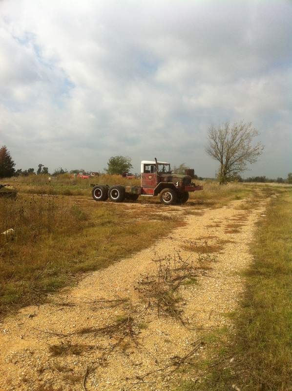

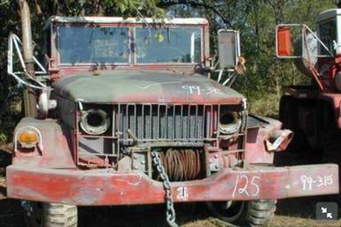

I was bored one night, browsing GSA. Noticed some local auctions. An M52 caught my eye, and I decided to go check it out. I ended up looking over several trucks, 5 tons and deuces. I glanced at the one I ended up buying, but didnt look over it like I should have. Long story short, the trucks I wanted went cheap, but more than I had budgeted. The truck I won was next to last, tired of being outbid I threw in $100 over my budgeted max, and a few minutes later I was the proud owner of a beat up m35a2. The first picture is from the auction listing.

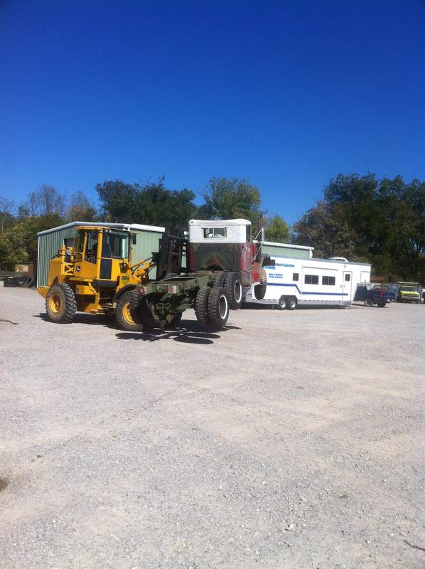

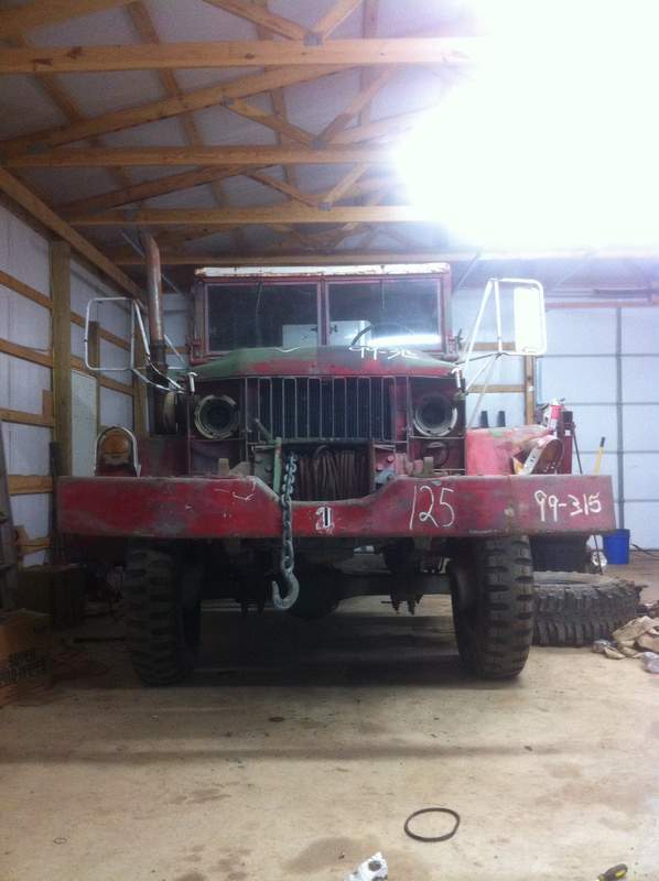

After payment went through I hooked up the gooseneck and went after it. The truck had previous forklift damage, so I saw no harm in letting them load it like they normally do.
After getting it home we discovered some missing parts. The FDC was gone. After some quick searching I found nothing, so I made a post. Warthog to the rescue. He had one, and the hardware to go with it, and I could come pull it that day. Turns out he pulled it for me, and had it waiting when I arrived at his house. Thanks again!
We pushed it in the shop and got to work.

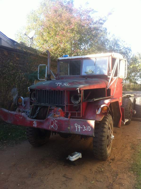

I've always been mechanically inclined, but knowing nothing about the Deuce really made for a steep learning curve. After about 20 hours of trial and error, with lots of help from the forum, she started and ran. We chased leaks for the next few days and decided to try bleeding the brakes. I wanted to build a power bleeder, but being short on cash I called a friend to run the pedal. After about 30 minutes all 6 brakes were bled, no leaks, all operational. All fluids were good. We moved on to the winch. It was rolled up so far the chain was into the drum and the eye that mounts the chain was stuck in the bottom cross tie bolt. The PTO worked and we powered the winch out. We took it for a drive. Drove good, not nearly as slow as I had imagined. But still plenty slow. Here's a shot from its first outing.
It was still missing a wheel, headlights/headlight rings, tail lights, mirrors, and some other things I'm surely forgetting. Warthog to the rescue again. He had everything but the mirrors and made me an awesome deal on them. Even took time out of his busy day to meet with me and exchange parts.

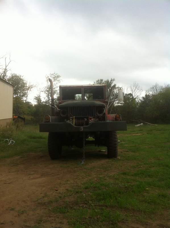

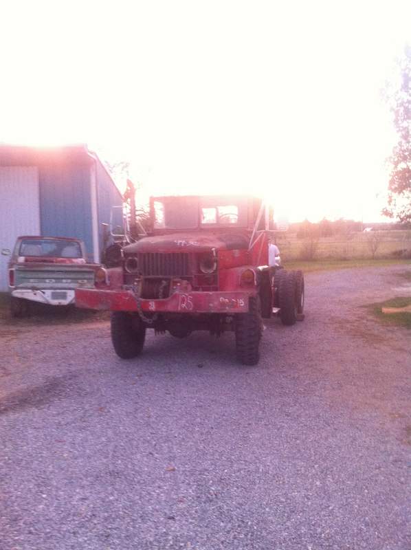

Here's what it looked like, running, but very, very ugly.

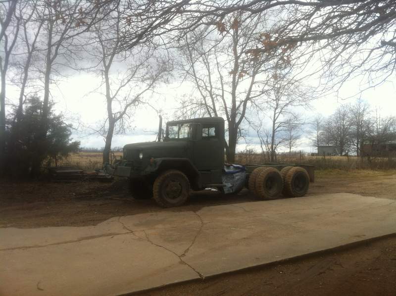

After getting it running and most of the issues addressed, I decided it was time for paint. I used a bottle jack to bend the fender back out, and to straighten the under door toolbox. Being lazy, I used rustoleum rattle can camo. I wanted to roll on the behr paint, but I didnt want to do the prep work. I'm paying for it now, paint flakes when mud gets on it, so I'll be prepping it and rolling it when it warms up. Here's a few pictures of before and during paint.
After getting it painted I drove it quite a bit. I was tired of working on it, and aside from a few issues it was great. It still leaks a bit, but I think they all do. I just consider it rustproofing. I used it to pull a truck out of the river one night, an 08 Silverado in water past the windshield. The winch worked flawlessly.

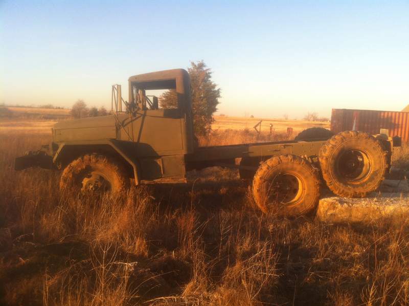

The tank was leaking, which ruined several gallons of fuel, so I started tarping the tank. Here's the only picture I can find of it from the side.

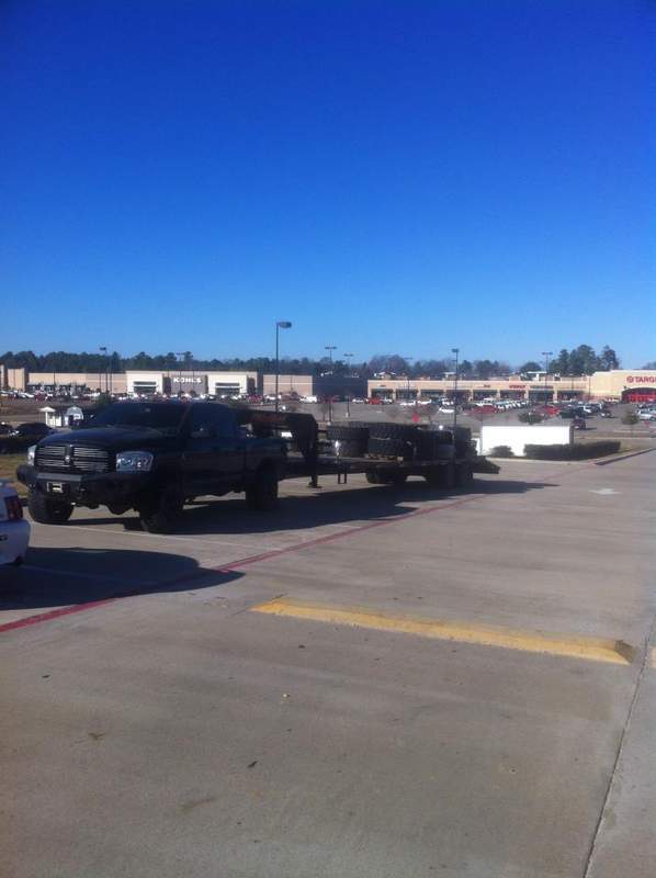

A few hours later and a little incorrect lot bidding I wound up the proud owner of 16 395's on FMTV wheels. 9 were MVT's, 7 were XML's. I was after the XMLs, but bid on the MVT's on accident. Assumed that I would be outbid on the MVT's, assumed incorrectly. So I loaded the gooseneck up again and headed to Texas. After a long drive I had them loaded up. Cant say enough good things about the Hooks GL crew, they were friendly and helpful.

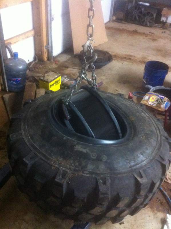

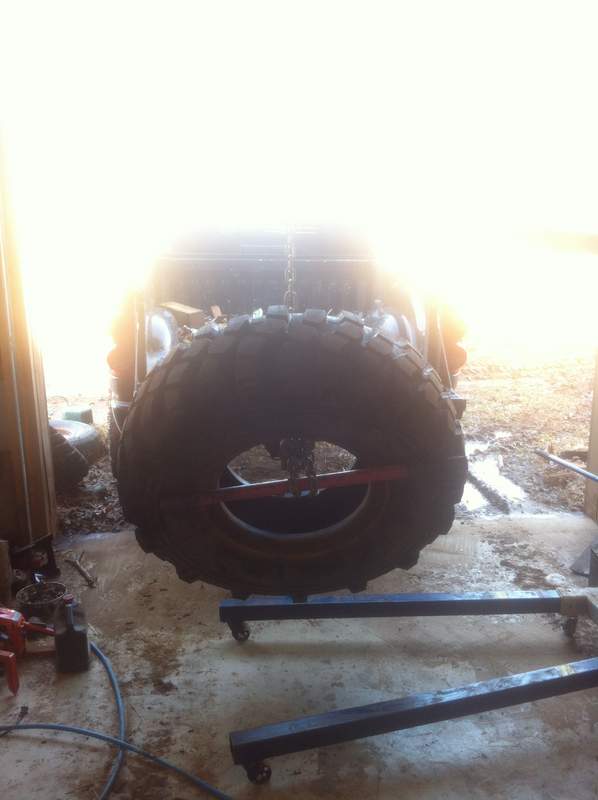

I used a cherry picker to pull the inserts out, ended up working out pretty well.
I also used the cherry picker to load a tire in the truck. I found a local place that was willing to touch the stock wheels, but they wanted to see the tire I wanted to put on there. Without any help, you have to use what you've got some days.
My shop was full of tires for over a month. It got old quick.

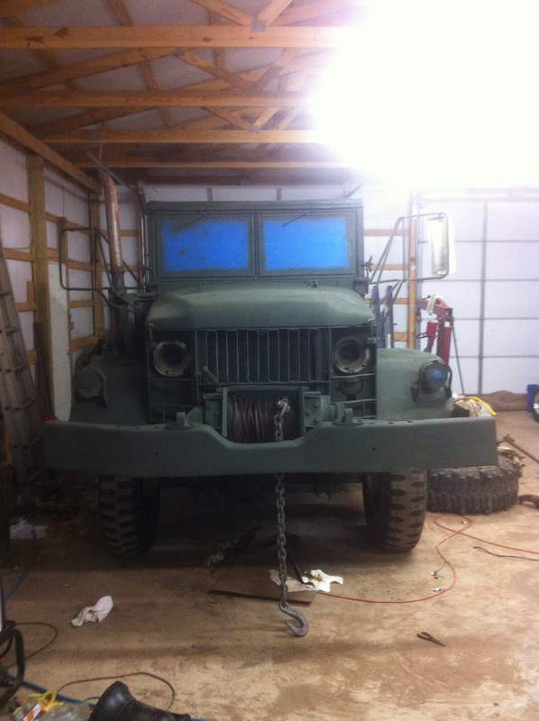

Fred's Tire in Shawnee, OK ordered me some 1400 tubes and got some flaps. They mounted 7 of them for me, it took a few days. Good folks. Very nice, good prices. Ended up only having a few hundred in the tires after selling the MVT's, which turned out to be a blessing in disguise I suppose. I called a buddy to help me mount them on the truck. He arrived after I already had 4 of them mounted myself. My floor jack want happy about that, but it got the job done. I inflated the tires to 45psi after reading different opinions on the XML's and pulled her out of the shop.

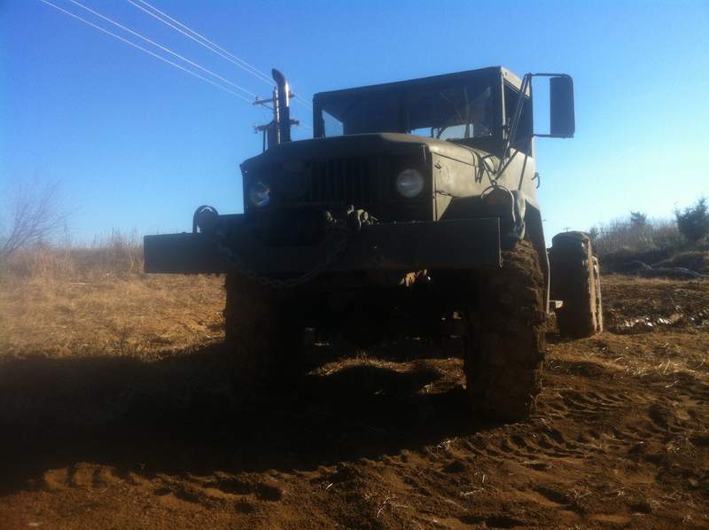

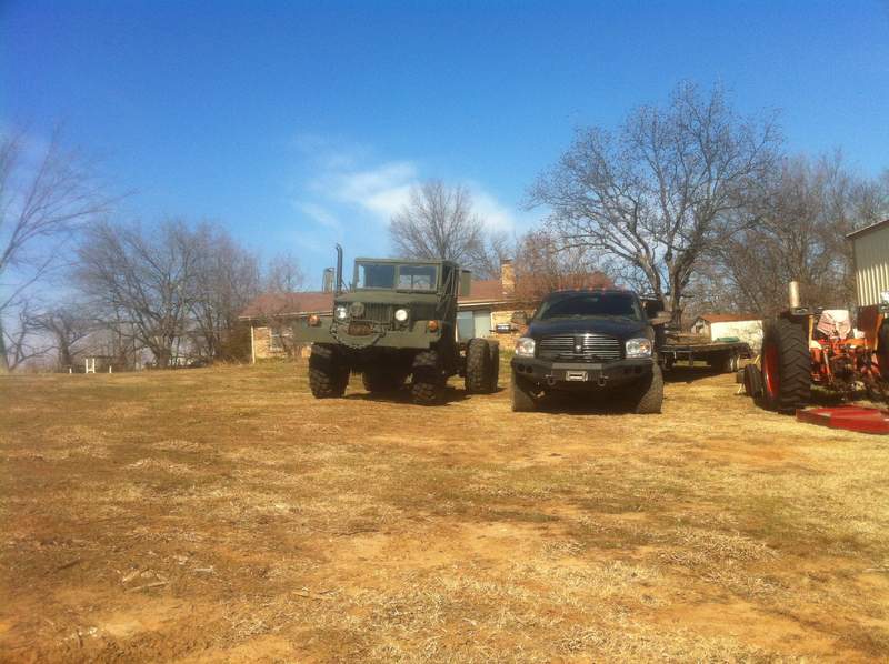

I've been driving it like this ever since. I really enjoy it. I'm getting set up to run waste motor oil, I think I've found a decent source. I've been running oil out of my vehicles and other trusted sources in it, it seems to like it. I've still got a few bugs to work out, and it needs a few more things. I'll upload one more photo here, and I'll continue this in my next post.

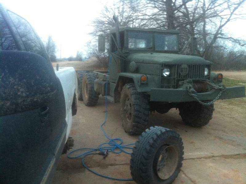

As with every Deuce owner, I always get asked what I use it for. Air compressor. My wheeling truck has a slow leak on one of the street tires. Good old 16.5's like to lose the bead. Solution? Mobile air compressor.

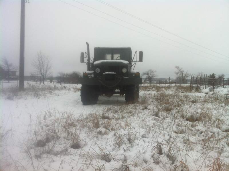

So I'm going to attach some of my favorite pictures of it, and stop being so long winded until it comes time to update this with new parts or good news.

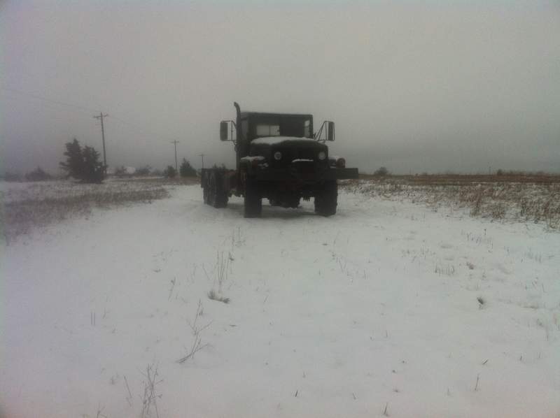

Not much has changed. I'm working again, but 55+ hours most weeks. The truck has begun losing prime, rather quickly some times. My lift pump is bad, so this equals a lot of cranking some days. I havent had time to troubleshoot it, but i can see air in the Line from the pump to the filter housing while running some days. Once started it runs fine. Any ideas?
It's camo now, but I didn't roll it or prep it again, so it still flakes. There was a two or three week period where it was out every other day or so pulling out stuck pickups. It's hard to believe how well this big thing gets around when you plan ahead a bit.
Still looking for a bed. By looking I mean I want one, but I haven't had one fall into my lap. I'm not sure how I would get it on the truck anyway, so that seems to be the biggest setback.
Its got two bushings that are looking pretty bad on the suspension links. I plan on finding two and replacing them before I set a bed on it. I'll try to put some new pictures of it up as soon as my computer is fixed.
