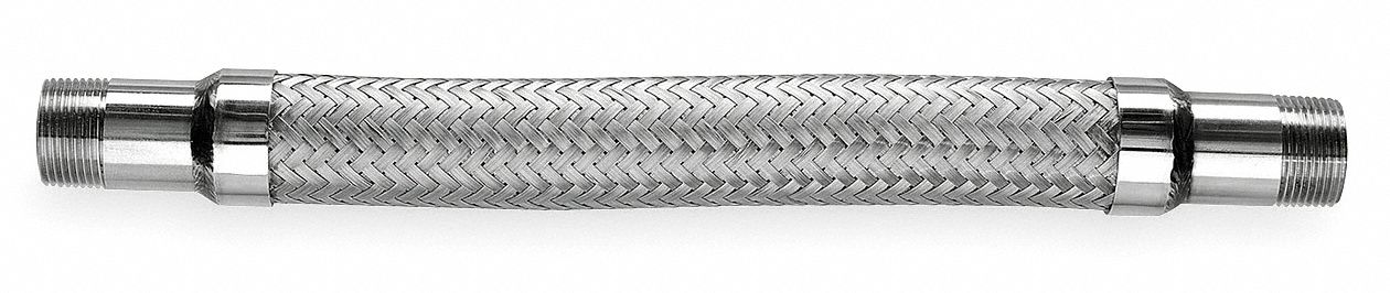

That's one nice looking set up! I can't tell from the pictures, but since you say you're getting a lot of vibration in the exhaust at the roof penetration, I assume you have it piped solid from the muffler to the roof? If so, that might eventually cause too much stress on the system and probably will crack either the muffler or pipe near the muffler. If you don't have any vibration isolation, Grainger ( and cheaper places ) have braided stainless flex pipes ( just like on a front wheel drive car exhaust ) but with NPT threaded ends. Might be worth a look.

Its not a crazy amount of vibration but yes it is solid piped and I know the risk.. Its a rig job to begin with, From the muffler I am using an NPT coupler to a thin wall EMT electrical conduit. I just half-arse tapped the ID of the conduit to accommodate the NPT tread. It keeps the weight down but regardless its not the best design.. I like the vibrasorber idea but those tend to be pricey and weld/sweat/solder on, at least in Refrigeration systems that I am familiar with. I could brace this to the roof and eliminate the vibration up top but its been running like this for 3 years without any problems. We had 1 good outage last year for 2 days that it ran nearly non stop.

Yes, they are about $75 for the NPT style, but... since you have some EMT tube in there too, the Universal flex joints for a car exhaust are only about $25 for the size you would need. Could weld it or clamp it in. But, as long as you're aware of the risk.... Regardless, you have an enviable install there!
