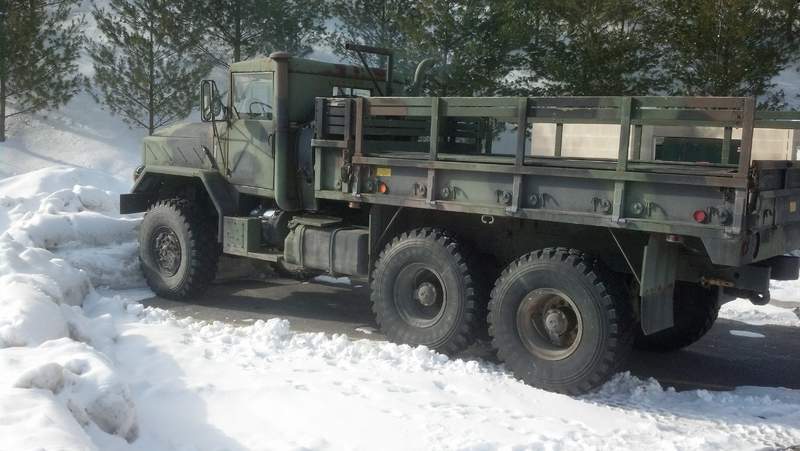

my new M923A2

Gimp not yet been studying it can not find anything in trouble shooting that all 5 lights on steady with no over speed light.
Those Military Guys
519
Rancho Cucamonga, CA
hey coffey
check your pressure transducer under the dash that is mounted on top of the ctis manifold on the floor i bet it is bad/internaly shorted or maybe one of the wires going to it are shorted
