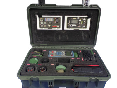

Anyone know what the 52 pin port (next to gear select lever) is for?
This is the diagnostic kit that connects into that port, the big module in the middle of picture one is what connects there. It’s called the DCA port and WDS-A from this kit connects in there wirelessly for diagnostics. You do need specialized software to use this kit. It’s available via folks on the forum. I have one of these for my FMTV so I don’t know much about using it on a humvee
