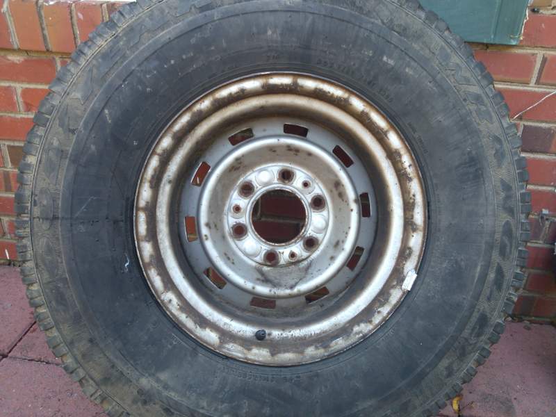

I would be going down as early as tomorrow morning to pick her up however I need to track down a spare wheel/tire for the trek back. Its too late in the day today to call around the local wrecking yards to see whats available. When I do give them a call should I just be looking for any 6 lug 1/2 ton Chevy wheel (15x 8 ) ?

After scouring all of northern Virginia I came up with this wheel. 15x8 6 lug. appears to be one of the rally wheels I've read works on the M1009.wheel.jpg

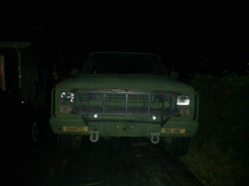

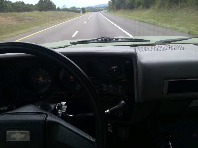

Well gentlemen, 6 and a half hours and 450 miles. She is home! What a long friggin day. Ill be posting some info on the experience and how she drove tomorrow or so and I would appreciate any and all input. driving home.jpgM1009 home.jpg
