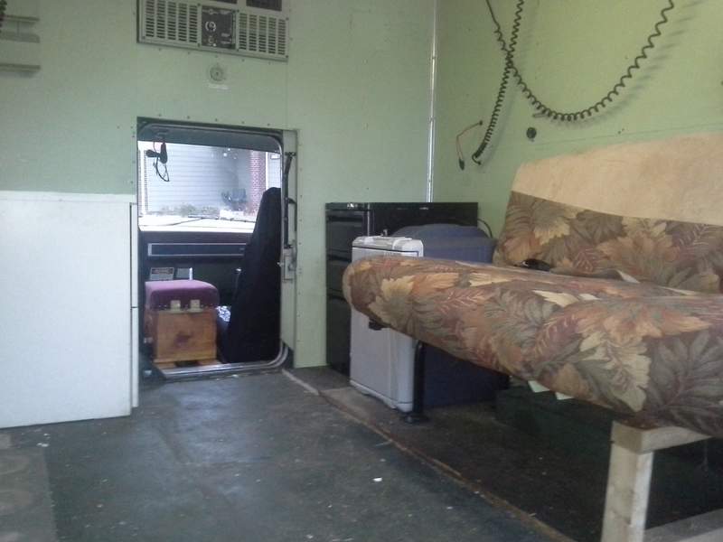

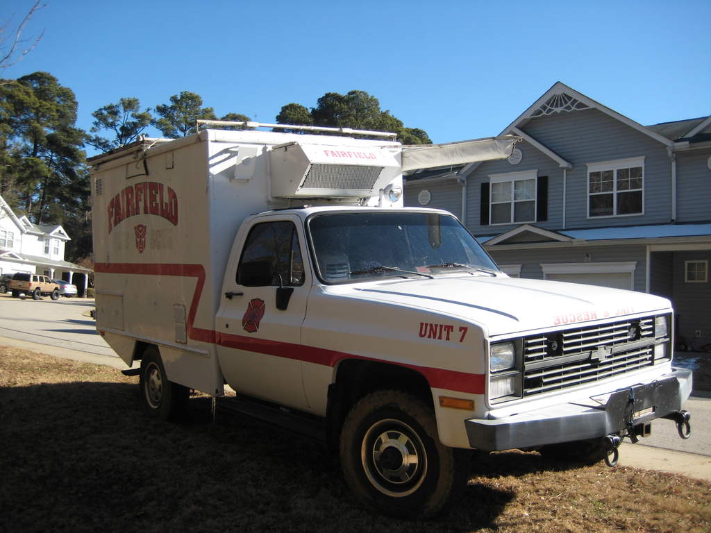

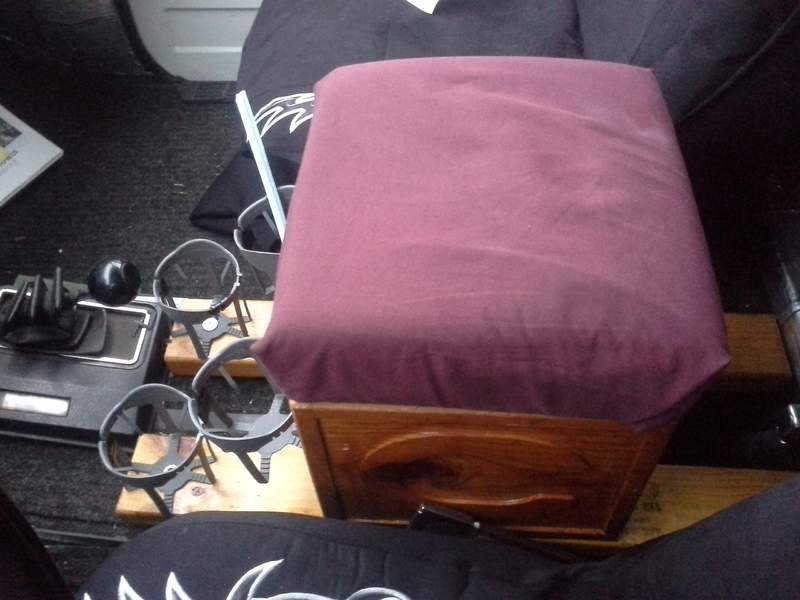

Hew guys. I'm new to the forum but have been watching threads ever since an M1010 fell into my lap a couple of months ago. I happened across a closed bid auction in my home town for a 1985 model with 3800 miles and all of the maintenance records going back 20+ years since the municipality purchase. All of the shocks, bearing, spring packs, both generators, brakes etc. had been replaced or rebuilt in the last five years and the preventative maintenance done once a year regardless of miles, along with indoor storage that left it virtually rust free. Basically, I couldn't pass it up. The back had basically been stripped of military equipment through the years, so no I did not take out any of the gurneys or stretchers to do the work I have done.
So far I have:

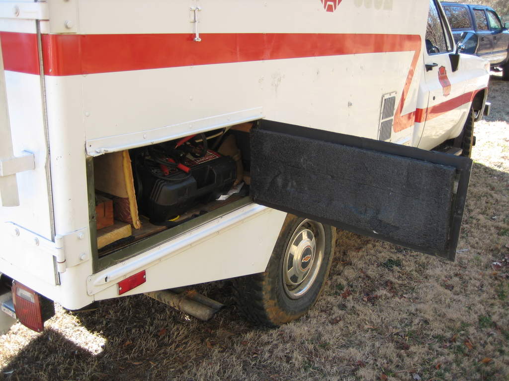

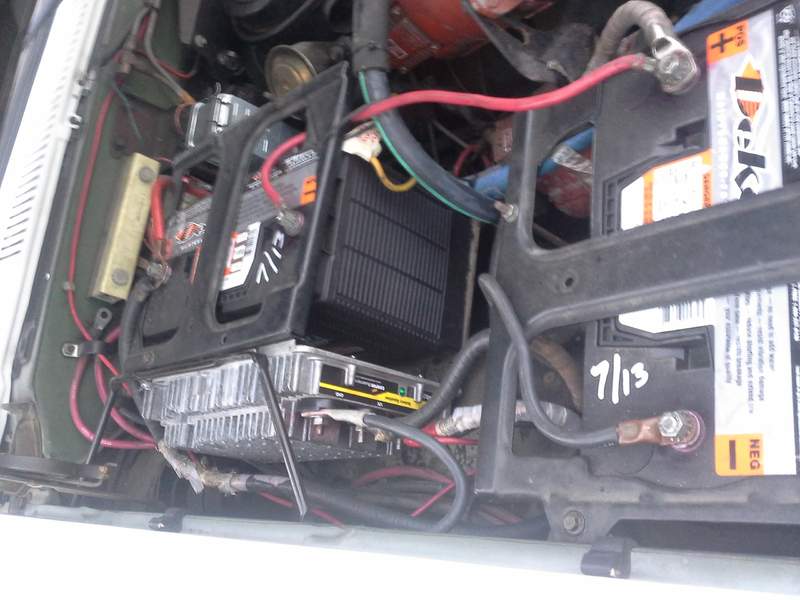

24 volt Battery equalizer with 100 amp 12 volt accesory leg

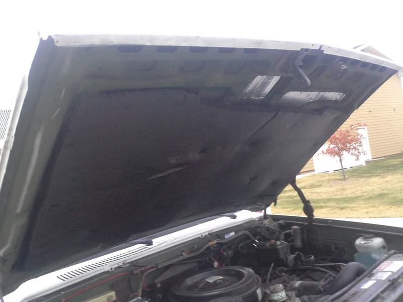

Hoodliner for noise reduction

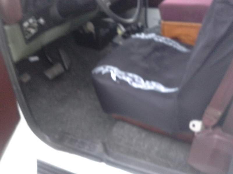

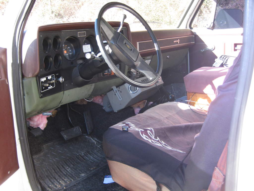

Sound deadener and carpet in the cab...

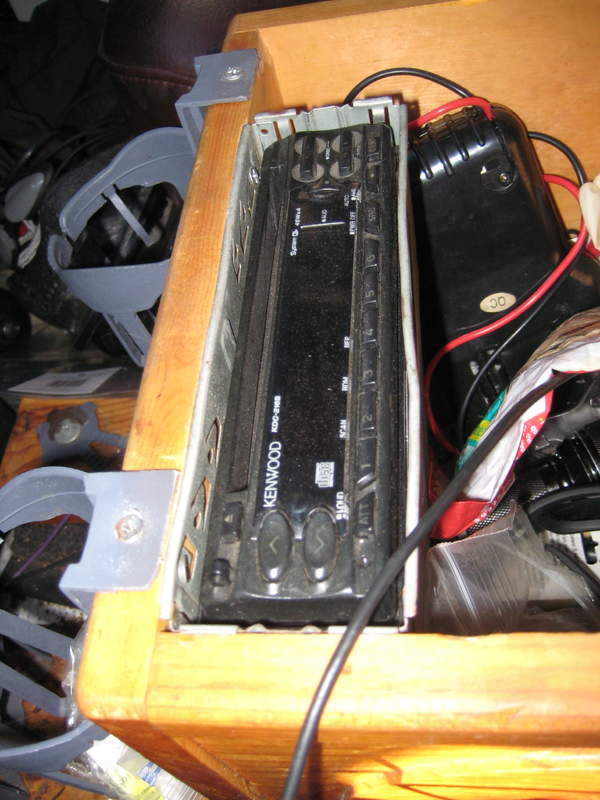

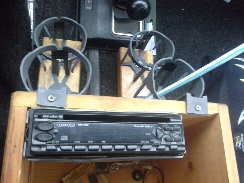

Center console
Cup holders
Stereo system

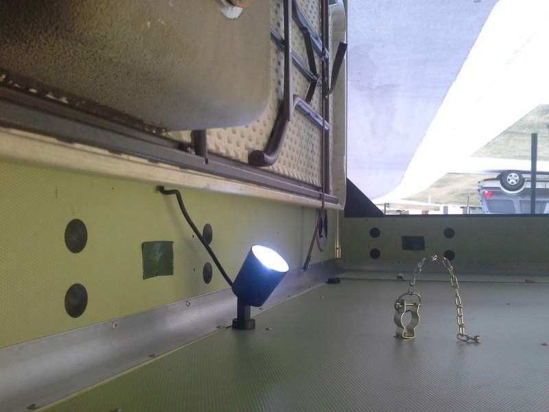

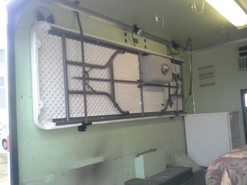

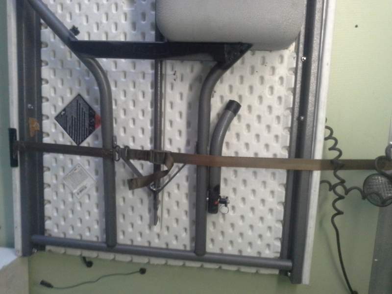

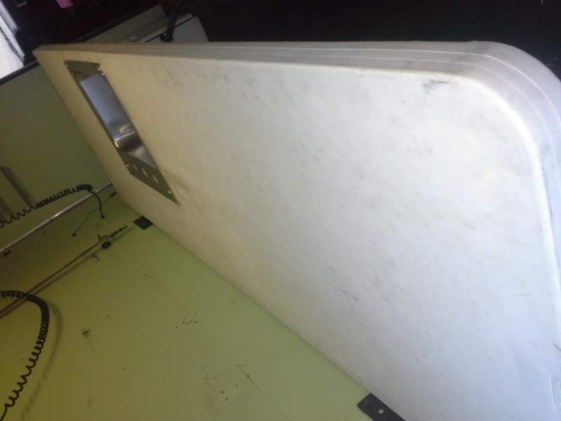

Multipurpose table (folds against wall, acts as counter/desk/dinner table when folded down in truck box, completely removable for use outside)

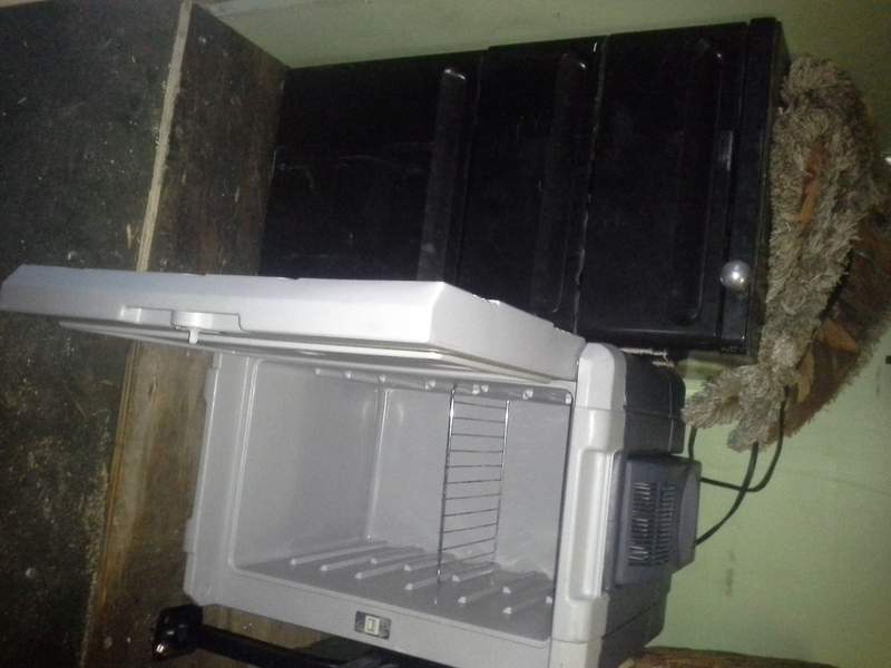

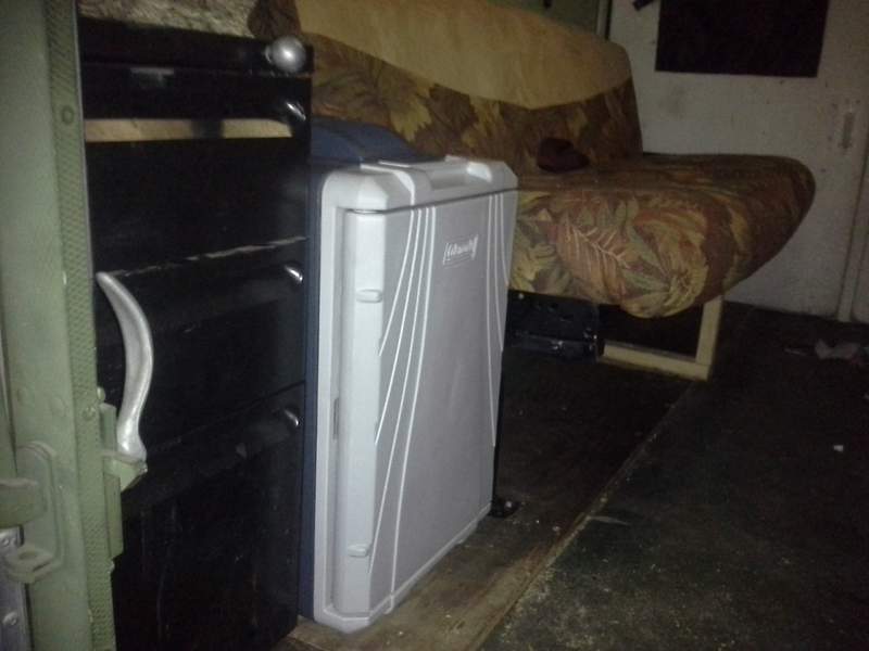

Latching storage cabinets (x2) that will also act as the base of a single bed

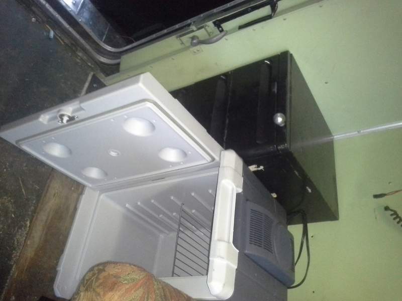

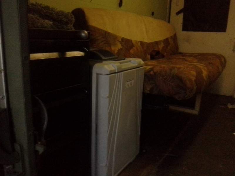

12v mini fridge that can be removed for outside use

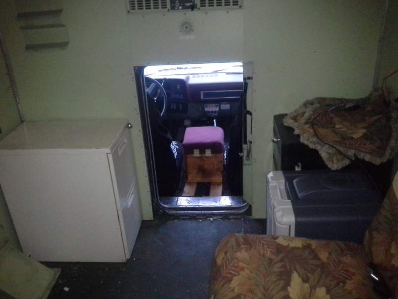

Seating for three (w/seatbelts) that converts to a "cozy" bed for 2

Auxillary battery bank charged from the secondary alternator (duvac deleted with equalizer install, just using 1 genny right now and haven't had a single problem)

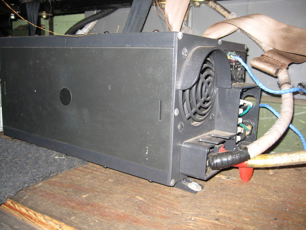

There is a lot of discussion about the DUVAC delete/12v conversion on here. I chose to go with a commercial service equalizer that I picked up from ebay for $150. it is working perfectly and has all the 12v output I need (100 amps). To me it is the simplest and most cost effective way to fix the inevitable DUVAC issue (mine smoked the day I picked it up).

That is some beautiful work. It's tough to get that battery area looking good because it's so busy but you nailed it. Very nice.

Thanks I cut my teeth on wiring working on security systems as a young troop and have practiced those skills quite a bit lately building a 12vdc/110vac generator/solar/battery setup in my off grid cabin in northern az. im a cheap bastard, so nothing is ever new or code built, but it works and fairly clean considering most of it started as stuff others considered trash.

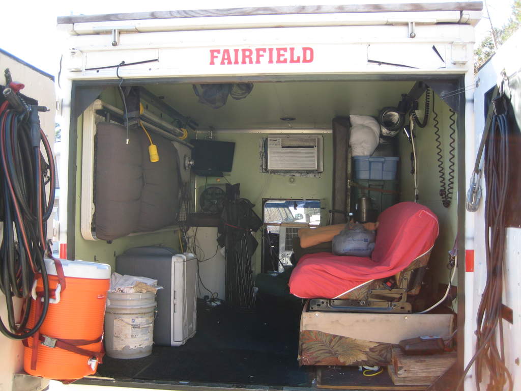

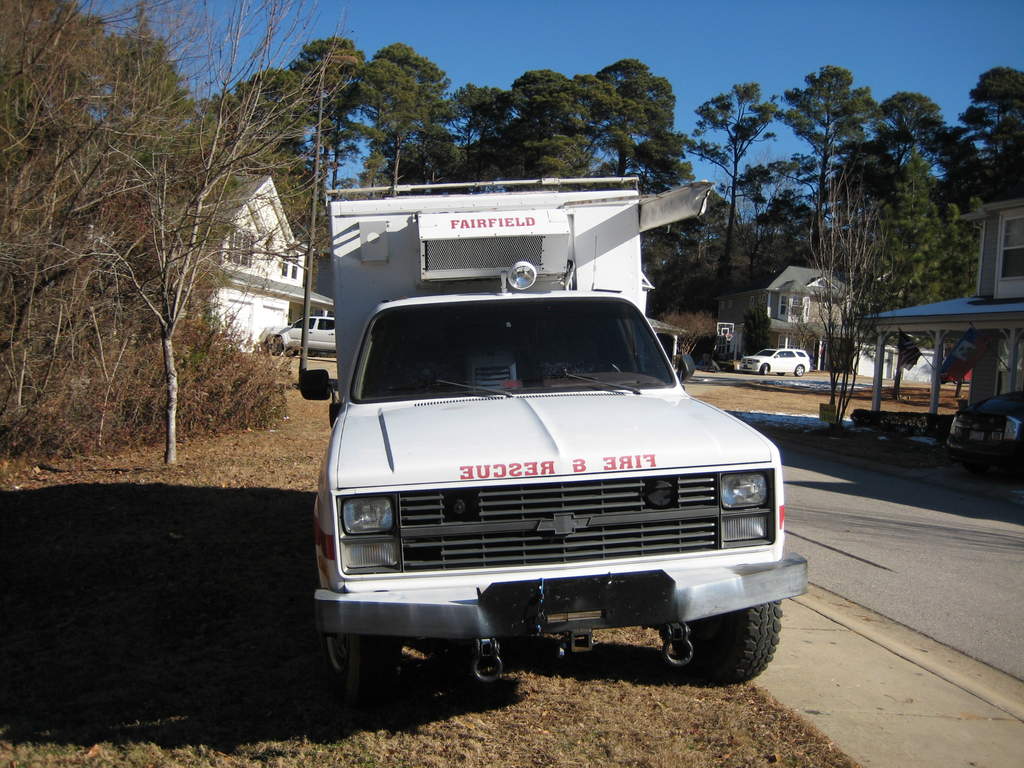

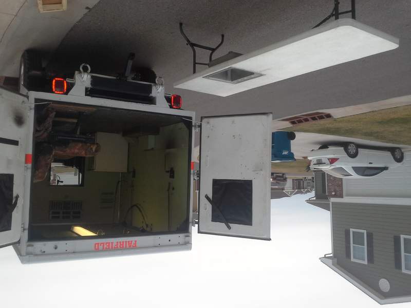

Its been a long time since I posted, but my M1010 project is finally complete Just in time for me to get orders to Kuwait for a year. Yay!
Custom feature include:
Rear bench seat with three seatbelts that folds out into a full size bed
single fold down sleeper at front of rear box
TV/DVD combo
Electric rear heater
6000BTU air conditioner
2500 watt industrial inverter (24VDC to 115VAC)
2x 100 amp battery equalizer units/12V accessory power sources
260 watt solar setup on roof
Roof storage
2x 130 amp deep cycle rear batteries
mobile cooking station/fish cleaning station with stainless steel sink
lockable storage
12V refrigerator/cooler with custom thermostat
shore power access
CD player/stereo
custom center console
cup holders!
auxiliary blower unit (ready for front ac install)
awning
tinted windows
search light
DUVAC system delete (24v battery charging system is much simplified!)
cool paint job, with transformer stickers
