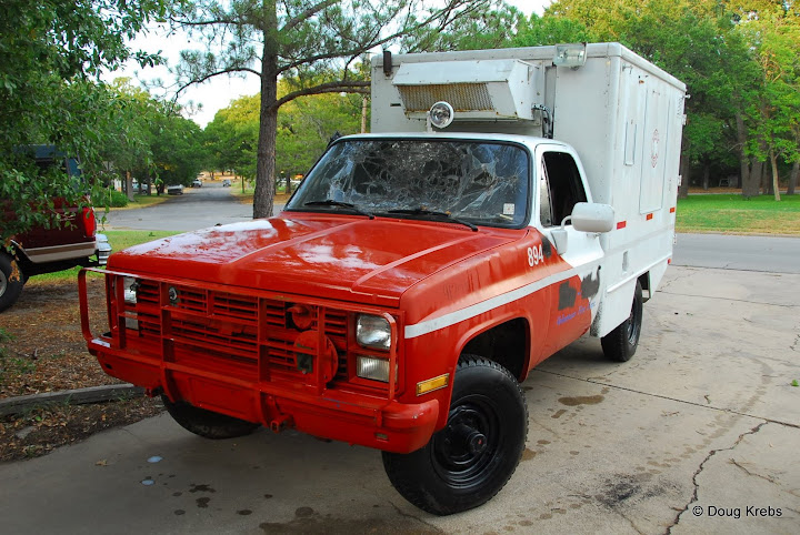

Oh no! What have I done? My new M1010

Thanks Lavarok. I'll have to see what the fire department has done to it. Obviously it needs a new windshield and god knows what else.
We'll see soon. Obviously I'm excited.

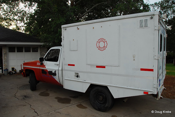

well congrats on the 1010 i also have one here in maine . I did a bad thing though i took the box off to make a flat bad truck . but any way if you need help I have also spent a lot of time with all the in and out of the 1010 . Just beware of the blue box dont let the blue smoke out . If you need i can tell you how to do the easiest 12 volt con. if your blue box is bad. I spent hours trying to find one when i did it was way to much to be worth buying .any way good luck with it

What did you do with the rear box? Any salvageable parts inside? I'm interested in you still have it.

i still have the box . i dont know just what is standred to be in it i has the a/c unit was charged all lights heater and gpu in it the to top beds are gone block and tactkle are gone but the out side lope is there . i have slept in it a few times thought were to use as camp were i cant get big camper in .but never know if need some thing pm me we will see if i got it or not .

I'll post some pics later, I've had a rough week. Figured out why all the cab windows are broken... Kids+Rocks.
I can't get fuel to the filter and sub sequentially the injectors. I'll start searching threads.

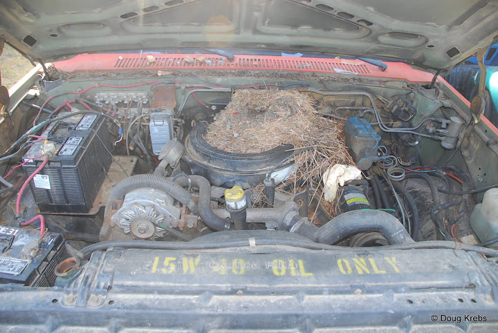

Got it running. Read a bunch of threads and figured out how to bleed everything.
So I've got some concerns. Someone cludged a 12v alternator on the engine. They dropped the 24v alternator below the 12v.

Looks like they replaced the top 24v alt with a 12v. That might actually work out better than the stock set up. You will have to let us know and more details on how they did it, if it does work well. Looks like it cleaned up well. How are they running the spot lights, they look like 120 volt?

Nice! If you ever want to get rid of the brackets to the front of each bench please let me know. The ones that go from the floor to the ceiling. I see your dome light works as well. I am still troubleshooting mine.
Also, in regards to your charging setup; the stock setup was [2] 24v alts. Sounds like you have [1] 24v and [1] 12v. If so, then the person before you solved the problem with 12v charging by taking out the top 24v unit and replacing it with a 12v. I'd like to see the mounting bracket used. I thought of this prior to installing my battery equalizer.

Interesting about the alternators... I was under the impression there was only 1 24v alternator.
The bracket for the top one was definitely homemade. If kept that setup I'd have to make a new bracket. I work in a machine shop, so I've gotten anal about things.

I think it was two 100 amp 24v alt for 200amp total @ 24v verses two 100 amp 12v alt for a total of 100 amps of 24v power in the other trucks. The orange wire conversion may cut the total output some also. The extra power was for the NBC filter kit which I have only seen in one truck on GL and the blowers in the AC.
