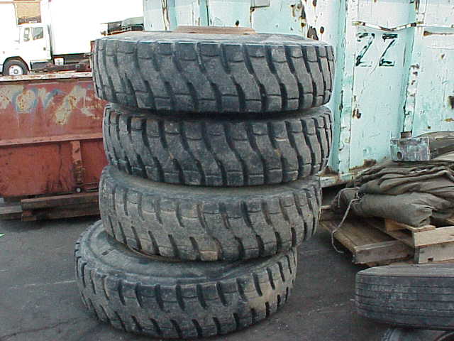

we have a set of 10 tires from a 10 ton, 9 are matched
all have heavy lug, look like retreads, already on the rims
also have a good running cummins engine from 10 ton and a good radiator
will make you a super nice deal if you take them all
give a call
dave
www.easternsurplus.net
215-598-8227
