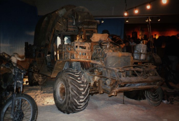

Nice work! I always said that if I had another good 1970's to 80's ford Bronco with body cancer issues I'd build a Mad Max type truck :)
