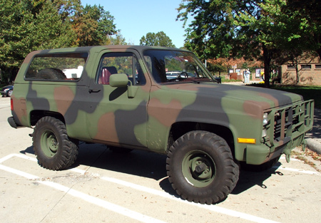

Hello, I bought my first MV in Oct. A 1985 M1009. Nice condition, runs mint. Had 56K when I picked it up from WI. Drove it home to Long Island, NY. I use it most of the week. I even did a 2 day trip to TN & back to pick up an M116 I bought. It now has 61K & know I could take it to CA & back with no fear of not making it. I have had a few problems with it but nothing let me down. I'll talk more details in the appropriate forums. Here are some pic's.

Show off :drool: [thumbzup] Looks real good. Who did you purchase it from? Also what size tires does that thing have?

Alfa is what I was thinking too, but I could not remember the name. His site lists 36"Goodyear Wrangler OZ as the tire on a similar M1009. I was thinking they might be Hummer tires, but those are 37", right?

I got it from Alfa Heaven. The tires are the Goodyear Bias Milirary OZ's. I like the looks of them but the truck still has the stock 3.08's & it's a total dog on take off. It does get near 25 miles to the Gal. & easly cruise at 80+ on the highway. In the next few months I'll be doing a gear swap. 3.73's will bring the engine very close to the original RPM level but I'm still debating if maybe going to 3.90 or 4.10 for the pulling power.

OK, to answer the tire questions. The tall tires throw off the Speedo buy just about 10mph. Truck fuel mileage turned into real math to figure out. Funny how a 21hr trip by yourself with no radio gives you plenty of time to work out mileage buy using mile markers on the road. The passenger tire rubs the inner wheel well when they are turned all the way to the right. Alfa Heaven did something I don't like to get the tires to fit. They trimmed the lips off the lower rears of the wheel openings. Now there 2 nice opening where dirt & water can collect & I know I will have rust issues in the near future. I figure about 2 more inches of lift will cure the rubbing issue. Second thing is that the trany is shifting 10mph later then it would with the stock tires. If I am pulling a hill from a stop it won't shift to 3rd till I've crested the hill. Anyone running these tires with stock gears is going to be replacing the trany within a few years. Other then that the trany is tight & shifts very smooth.

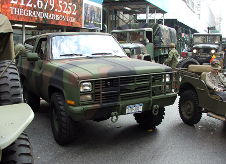

Here are some pic's I took on Vereran's Day in NYC for the Parade I was in.
