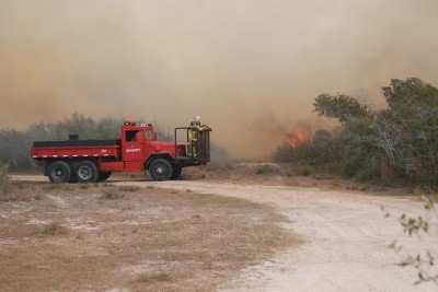

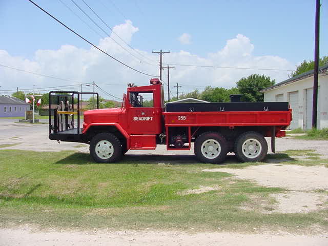

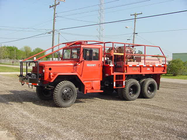

Our two deuces:
#255
1968 AM General M35A2 WO/W
1200-gallon water tank
placed in service 2005
#256
1968 AM General M35A2 W/W
500-gallon water tank
placed in service 2008

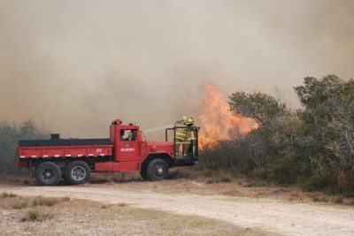

those look pretty cool! did you do the additional fabbing on the front bumpers?
We had two different local shops do the steel work, hence the different paint jobs.
We designed the WO/W deuce as a "heavy" brush truck ( the one with the walk-on front bumper ) and the W/W as a "light" brush truck.
The W/W has worked out great pulling other fire department's deuces, 5-tons, and smaller brush trucks out of the mud. We're the only one in the county with a W/W ( that works ).
Both trucks have had the exhaust re-routed w/ mufflers M35A1 style, this has worked out great. Also the W/W was a non-turbo truck, we added a "D" turbo to it a few months back.
