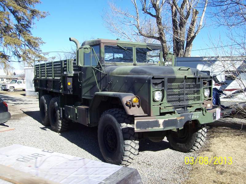

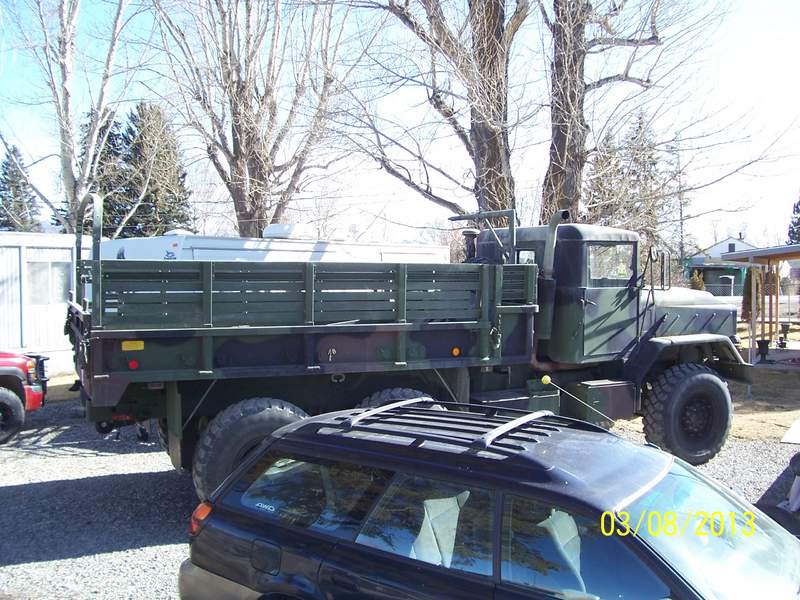

Hey peeps, I figured this would be a good place to make my own thread on the new Truck. :driver:
Here is a few pics, She is an 1986 and one of the 4 tags in the door jam says 08-10 on it. I take it that was the last time it had any major work done to it? More later Stryker

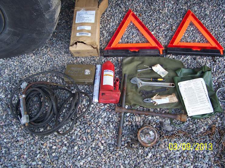

Cut the lock off the side box and found all the tools and a manual. Brand new 8 ton jack to boot.

Cut the lock off the side box and found goodies inside. New 8 ton jack was welcome for sure.

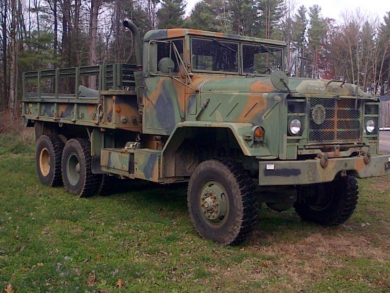

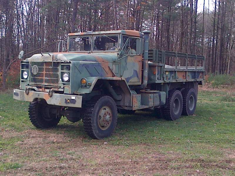

.... I have been
threatening to add a like mirror to the right front top
corner of the hood. There is a HUGE blind spot from
the rear of the cab forward where you just can not
see a tiny civvy. Anyone done this?
Here are a couple pics of my truck, came from GL with the mirror. Honestly can't imagine driving it without it, I use it alot.
