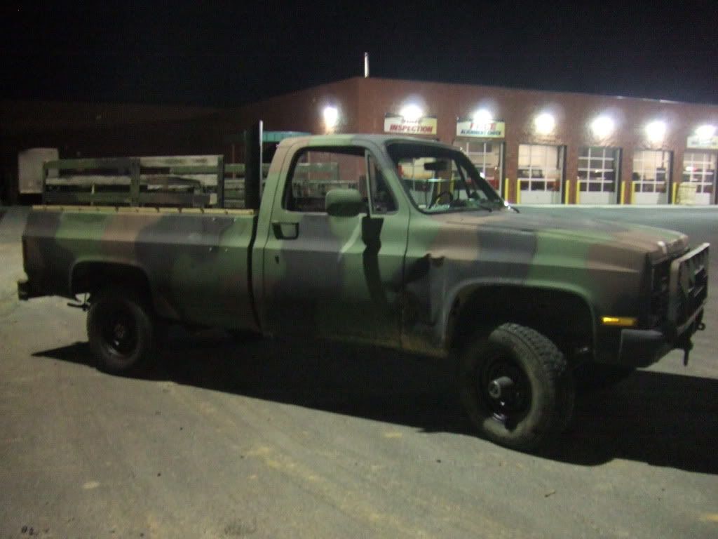

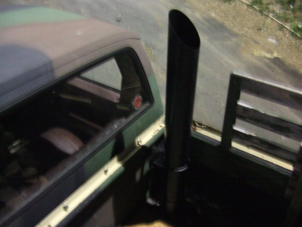

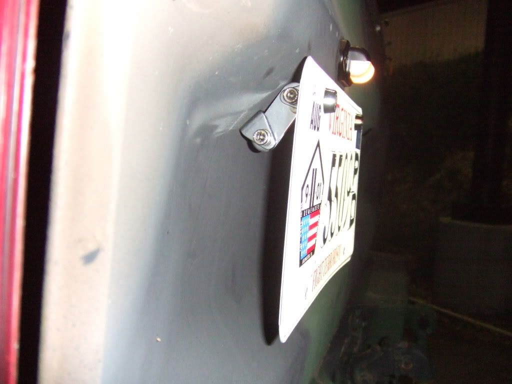

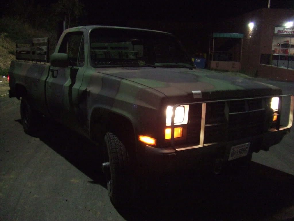

hey guys. i just figured id take a couple pics and a vid of the truck since i got it up and running and inspected. they aren't much cause its dark. ill be sure to post some better ones up later on this week. we just finished installing a 5" stack, a tag bracket on the tailgate, painted the wheels and fixed a few other odds and ends.

nice mod to the exhaust,
you know -
2 exhaust manifolds
2 down pipes
means
give me
dual stacks

yaa you have dual exhaust why dont you have dual stacks . ya dual 3-4 inch straight pipe stacks sound sooo sweet nice bark when want nice purr when want .

Im with you guys. i love the look of dual stacks but i was also going for sound. my dads p30 step van with the 6.2 in it has straight pipes. its crazy loud but im not a big fan of the clapping noise that it makes at higher rpm's. 1 stack also keeps the price down:)

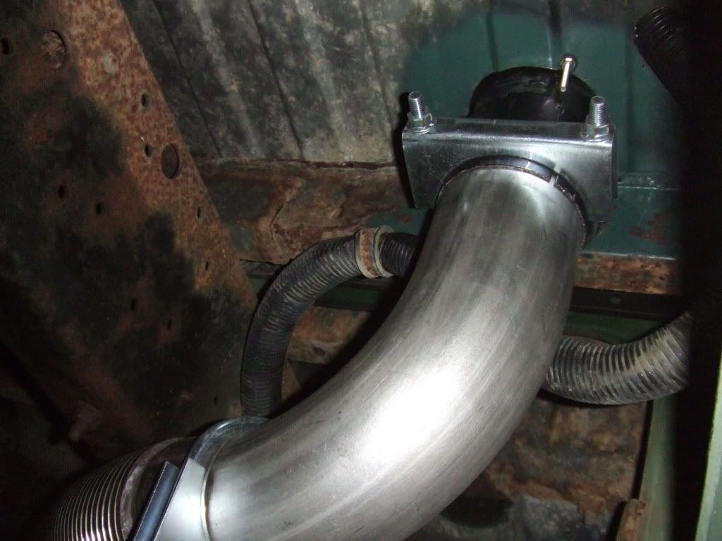

Both sides are run into the one pipe. i didn't have a y pipe and couldnt find a dual 2 1/4 into 1 four inch anywhere so we went ahead and welded a piece of flat steel onto the end of my 4 inch flexpipe, cut two 2 1/4 inch holes in it and welded the pipes directly to that. i try to get a coule of pics of that as soon as i get a chance.

ya please do id like to see that because i want to do the same thing and im havin a hard time figuring out what to do
