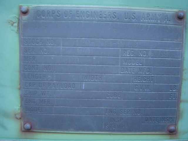

Data Plate says:
CORPS OF ENGINEERS, U.S. ARMY
National Stock Number (N.S.N.): 2510-649-8384 (if you want to look this up online try adding a couple zeros for the second set of digits "2510-00-649-8384")
Nomenclature (NOM.): Body, Cargo TOOL MOUNTING
ENG 7&8
MAKE: METRO ENG & MFG
Model (MOD.): BCTM (if there's more, it's illegible)
Inspection (INSP.): (a mostly illegible stamp)
Serial (SER.): 533
Manufacture Date (MFD.): Nov 1960
FOR USE WITH
Nomenclature (NOM.): ORD CHASSIS, M-116
F.S.N.: 2330-542-5987
Model (MOD.): M-116

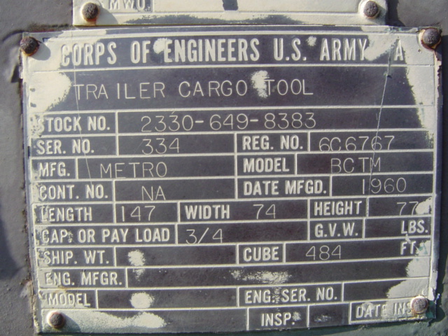

NOTE: I originally thought the Model read "BOTM" but I'm fairly certain now that the 'O' is actually a 'C'.
I found other 1960 Pioneer Tool trailers on the internet and with data plates that also have a Model of "BCTM".
http://www.vintagemilitarytrucks.com/1960_Pioneer_Tool_Outfit_Trailer_6C690_j.JPG
http://www.vintagemilitarytrucks.com/1960_Pioneer_Tool_Outfit_Trailer_6C6767_data1.JPG
However, looking up the Acronym ("Brigade Combat Team Modernization") seems to imply that the acronym didn't exist until fairly recently. *shrug*
https://en.wikipedia.org/wiki/BCT_Modernization
Anyone know what "BCTM" means, if otherwise different than the above?
My guess: Body Cargo Technician (or Technical) Maintenance
