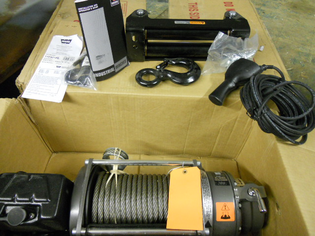

I have found them for about $2600 all set up. You can get them 12 or 24 volt. They are Warn Industrial winches. The biggest they make,18000lb. winch, comes with 75 feet of cable. What I have been told is you really need the auto winder to go with the winch or the cable gets messed up on the first pull.
I am going to mount them front and rear. Don't know where on the rear yet but I will get to that when I get them. However at this time for the price of a winch I can buy a really good deuce with winch. So the Warns are on hold till I have Donald Trump money.[thumbzup]

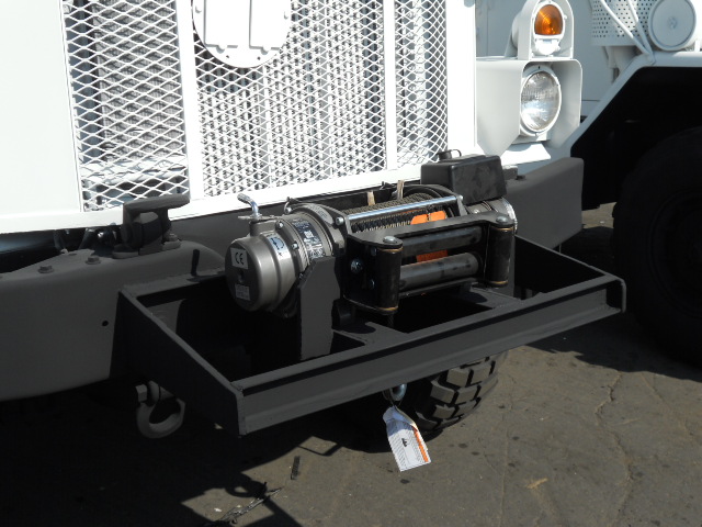

I'm currently in the process of installing a Warn 18K 24 volt wench on the front of my A3 right now. It is being mounted between the frame rails and should be complete in a day or two. I will be posting pics in the Deuce Hotrod forum when complete.
There is a guy in FL who has a pallet of surplus Warn 18K 24 volt wenches for $850...
Warn Winches, 18,000lb, NEW

I am in the middle of installing a 15000# WARN 24 volt winch on the front of my deuce right now. I have pushed my front bumper out 6" to allow it to tuck behind the bumper [cut 6" long pieces of the scrap frame I had left from bobbing my deuce and added 3/8" thick flitch plates with 8 grade 8 1/2"x1-1/2"bolts each side]
I just got the bumper back on tonight; what a pain doing it by yourself-getting the bumper off wasn't easy and getting it back on and getting the 10 original bolts to line up with the pieces I fabricated took some doing.
The winch will bolt to a 3/8" thick plate I am mounting behind the bumper; I am leaving the bumper with the "notched" area down and the fairlead will be mounted there.
I will post pictures if I ever figure out how.
If you have questions in the meantime, PM me.
