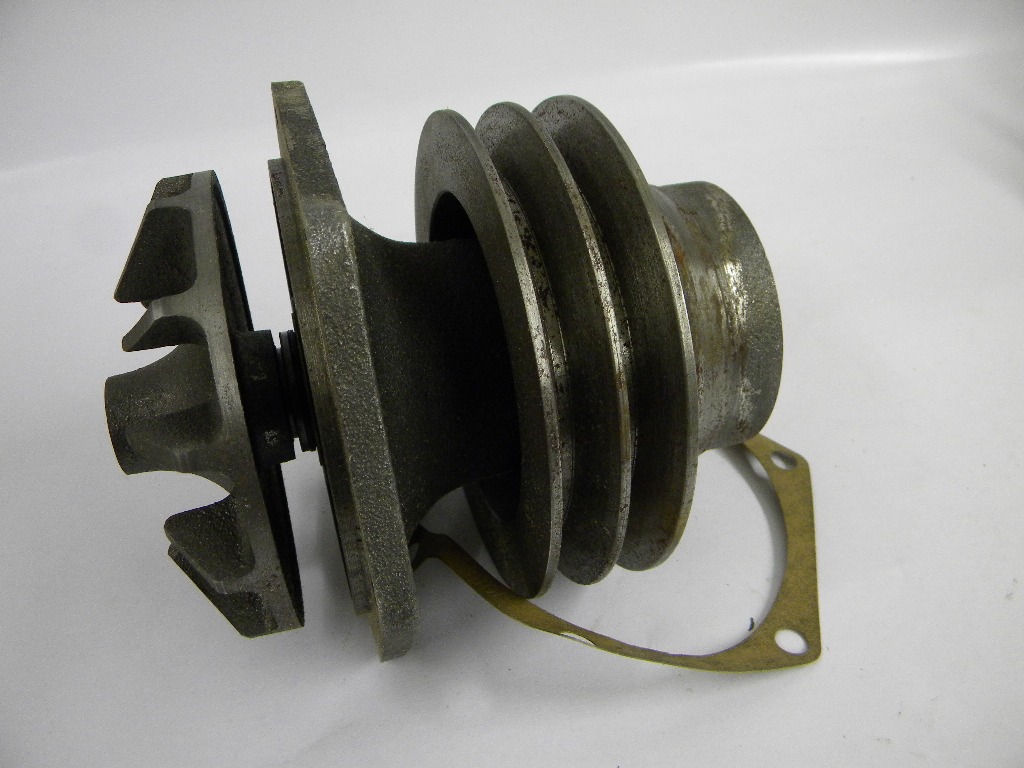

My water pump went out today. I was letting the truck warm up before heading out and noticed a rattle toward the front of the engine. I opened the hood to find the fan wobbling badly. I shut it down before the fan ate the radiator. The shaft has about a half inch of side to side free play but believe it or not, it wasn't leaking a drop.
Does anybody know if you can get rebuild kits for the multifuel water pump? I was going to buy one of the $100 water pumps listed in the classifieds but thought I'd see if anyone knew of a kit before I bought a whole pump.

Ty I don't have your answer, but I suggest you may find it useful to press the pump apart and identify the bearing and seal pieces for future reference.

Will do Rick.
Alot of water pumps use the same bearings and shaft, even between manufacturers. I may go ahead and buy the complete pump because I need the truck up and running fairly quick but I'm still going to try and find the correct rebuild parts if I can.

Did anything ever come of the water pump rebuild? I'm not having any luck finding info on how to do it, and I'm in real need of my pump being rebuilt.

My great thanks to you both. I think a new unit may be the only option I have. It doesn't look like there is any info on rebuild kits, not that my computer skills are any good.
The danger of the fan taking out the rad is one reason why I replaced the steel fan with a plastic one from Summit Racing. The blades can be trimmed to fit with scissors, it moves a lot of air and is easier on the water pump bearings than the heavy steel fan.

I had a fan eat the radiator on my '62. I noticed recently on my dropside that the clevis that attaches the radiator to the front of the block is adjusted too far in, putting the radiator dangerously close to the fan. Delicate balance between that and the hood latch catching the front of the radiator it seems.
Dropside water pump is wobbly, noisy, but not leaking. Reckon I will attempt to disassemble and replace bearing.
