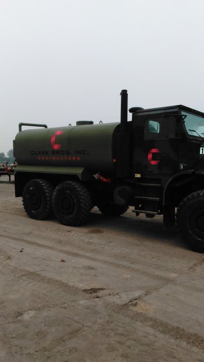

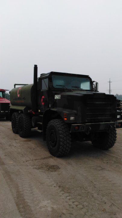

8 thousand...Very nice! What gallonage?
Sorry, 4,000 gallon tank.Looks like a 1000 gallon tank from here which would hold 8000 pounds of water.
A 7 ton truck should be able to haul that on improved roads. About 750 gallons on unimproved roads. The greatest car must be taken on unimproved roads not to roll the truck over on a side slope. Tanker rollovers are supposed to be the leading cause of LODD in apparatus accidents.
Yes scary.4000 gallons really ? That is like 33,000 pounds of water on 3 axles ? How are you planning to get it to stop ? This is almost tractor trailer loads and they have five axles to your three.
Yes, they are...Are the tanks baffled?
