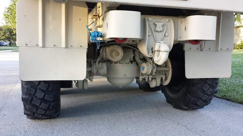

Went to super singles on my M923
RobM923
FL

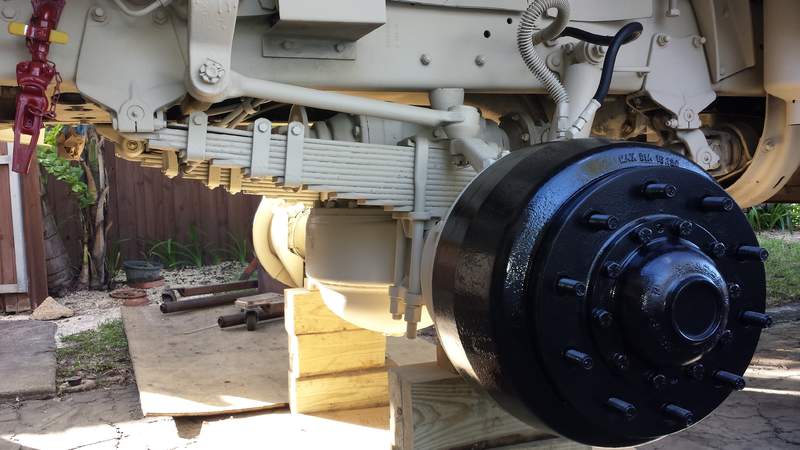

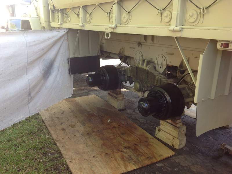

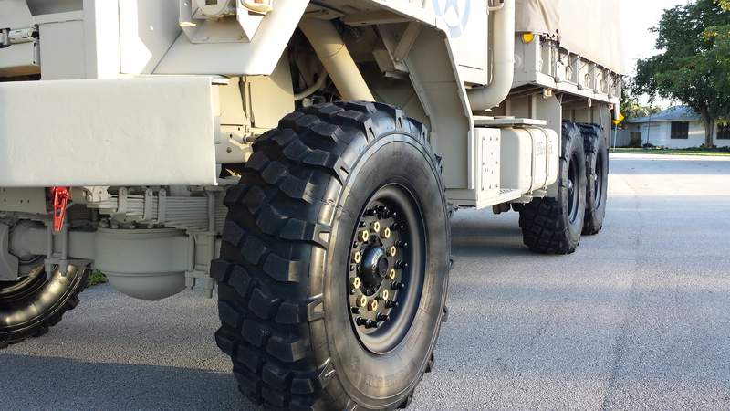

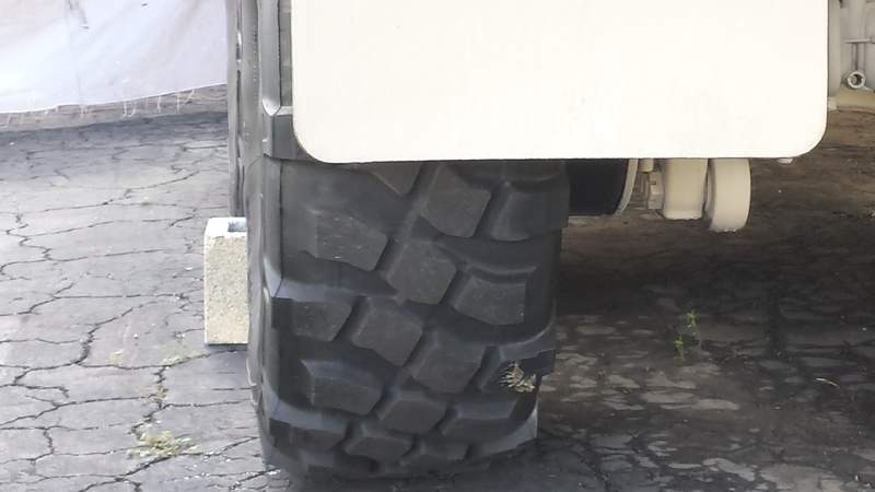

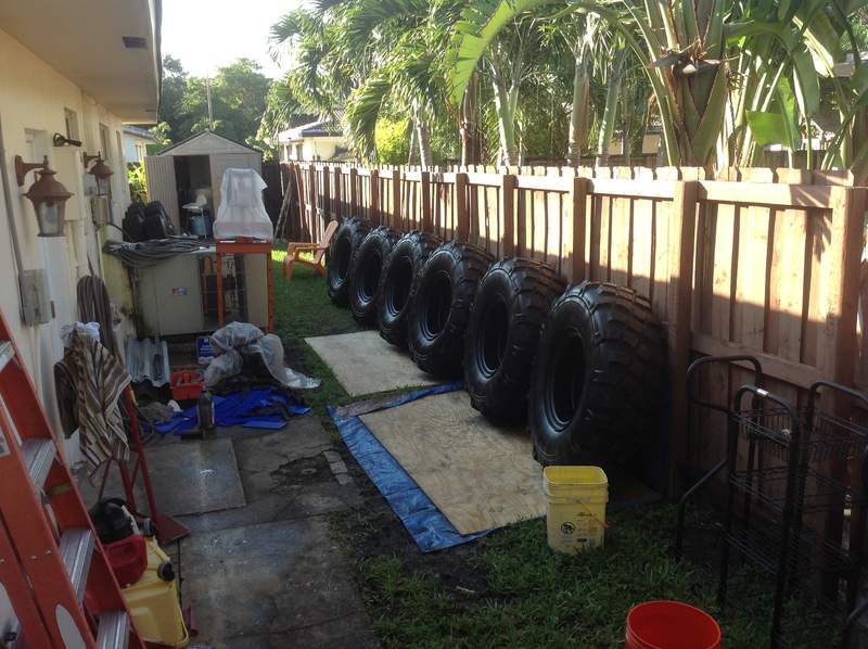

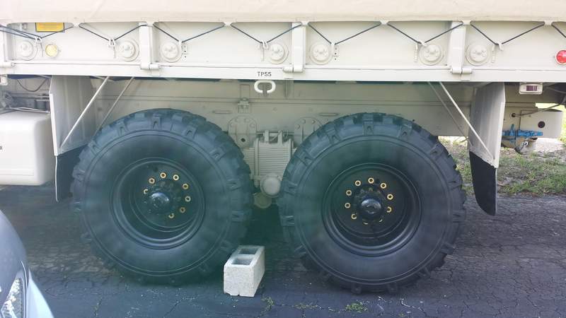

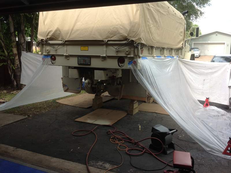

Swapped out the wheels my truck came with and put on super singles 395/85 R20 Michelins on HEMTT wheels. Though the wheels were new they needed a little restoring, I painted all pf the bolts and nuts with self etching phosphate primer and did the wheels in flat black.

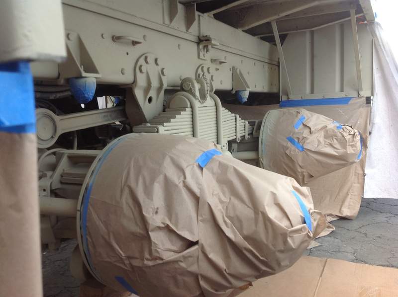

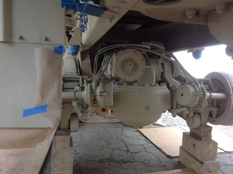

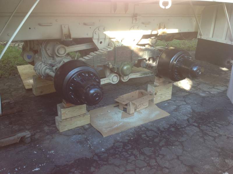

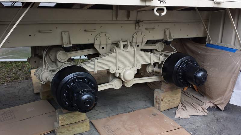

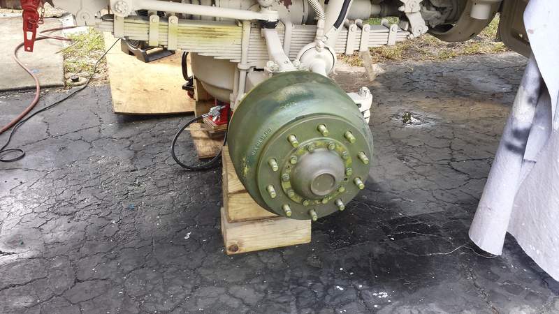

Since I had the wheels off the truck I took the opportunity to redo the paint underneath and detail the suspension. The drums were also done with phosphate primer and finished with high temp black paint. I wanted the new lugs to be yellow cad but couldn't find them in that finish, so I purchased new lugs had them stripped and re plated in yellow cad. The truck came out exactly as I envisioned it and I really like the way it rides.

While the paint was drying, did you inspect and service your brakes and bearings?
Or, it just a static display truck?
RobM923
FL
I checked one set of brakes and they were perfect, the truck only has 8,100 miles on it. Didn't see the need to pull off 4 drum and hub combinations that weigh around 130lbs. each just to look, especially since I worked on the truck by myself.
Not sure how to take the "static display truck" comment. I drive my truck all the time, I've put 1500 miles on it in the last 8 months, my truck looks the way it does because that's how I want it to look. The day I hear a wheel bearing noise or my brakes have a problem, I'll take it apart fix it, and if I scratch the paint...I'll re paint it.

You can pull the dust covers off the backing plates and look at the brakes without having to remove the wheels or disassemble the hub assembly.
