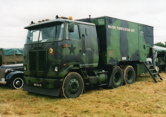

Here is a picture of a White Water Purification Unit I took a few years ago. Can anyone tell me if these trucks were actually used in this role? I have never seen them in any service photo's?

Haha, that truck isn't white, its camo! LOL. The body is a correct 1500 gph water purification unit used on the M45 and M45A2 chassis but never seen it mounted like that on a commercial truck. BTW it is mounted backwards.

I did wonder how it was mounted. The way the bottom of the unit drops where the back wheels should be. Interesting. I wonder who fitted it like that? If I see it again I will speak with the owner.

That's a civy job. The real thing sits on an M35 chassis. There are a few members here that have the real thing and are really cool!!!!!!

This truck belongs to Keith Broome from Manchester. He has made the purification unit into four star accomodation for going to shows and rallies

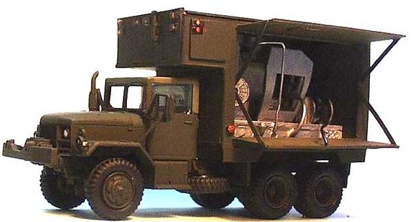

The van-type body mounted water purification unit, Met-Pro Model 1500-2600, consists of water purifying equipment installed inside an insulated and heated van body, mounted on a M45 2½ ton truck. The water purifying equipment consists primarily of the water treatment section, where raw water is mixed and treated with chemicals; the filter section, where chemically treated raw water has impurities removed; and necessary valves, piping, and controls to direct production of potable and palatable drinking water from fresh water at the rate of 1500 gallons per hour. Supporting equipment required for the unit includes a 10KW engine-driven generator set, mounted in a standard 1½ ton cargo trailer. The water purification set is constructed for movement over rough terrain as well as smooth surfaced roads. Areas traveled are limited only by the capability of the truck upon which the water purification unit is mounted.
Manufactured by Met-Pro Water Treatment Corp. Environmental Tectonics Corp.
I made a model of one; I will take and post pics soon.
