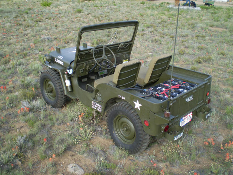

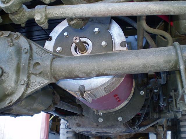

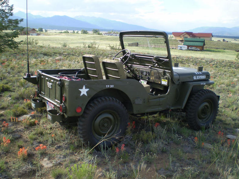

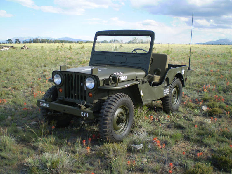

I just wanted to share some photos of one of my projects. It's a 1952 M38 that's been converted to all electric drive. I took out the gas engine and replaced it with an 11 inch Netgain electric motor. The original flywheel and clutch are still there. So is the rest of the drive train, including the 4wd. It's powered by 18 - 8 volt batteries that create 144 volts. Since these are all deep cycle batteries, they store 23kW of power. It'll run over 65 mph pretty easily, but at that speed it really sucks down the power. All those batteries add over 1,200 lbs to the jeep. And I can only get about 25 miles to a charge. The on-board charger takes about 8 hours to fully charge the battery pack when they are almost completely discharged.

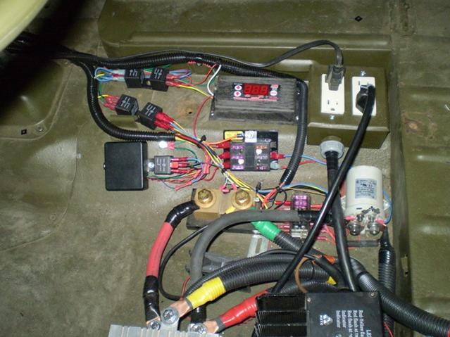

One of these photos shows all the electronic controls that replaced the gas tank under the driver's seat. My intention is to make this jeep a daily driver to commute back and forth to work. I've got an arctic hard top that I plan to put on it for the winter months. One of the comments I get from everyone who's driven it is just how quiet it is. All you hear is the tires crunching on gravel, and the wind, and a little gear whine in the transmission. Other comments include how smooth the ride is with all that weight, and how much power it has. I can spin the tires in 2nd gear on gravel. I can start in 3rd gear from a dead stop. It's a fun rig to drive! [thumbzup]

My cost so far is about $7,000 for the conversion. That doesn't include the basic jeep. What I've discovered is the Flooded Lead Acid batteries are the cheap way to power an Electric Vehicle, but they definitely are not the best. What I'd really like to have are Lithium Iron Phosphate (LiFePO) batteries, but they cost about 5 times what lead-acid batteries cost.
I'm going to put the batteries into two large wood crates that I'm custom making for this purpose. I'll have one crate for the 10 batteries in the back, and one for the 8 batteries under the hood. That'll keep me from dropping tools on the terminals and creating sparks. It'll also help me keep the batteries warmer in the winter.
