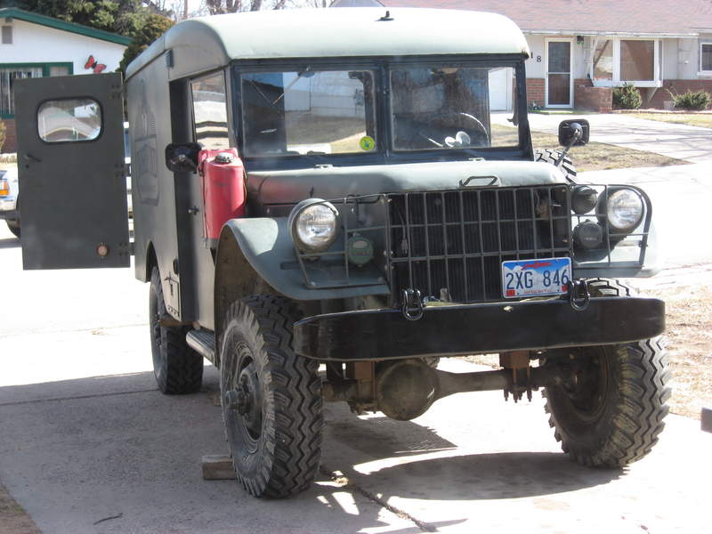

Those front blocks should not be there
In my inexperience I thought it was stock.
After looking closely it looks like the oil pan will be resting on the axle if I take the blocks out.
I don't know what to do.
forgive me but
i dont know crap about these things
never even seen one of these trucks before
except in movies
gerrykan
386
SGF, MO
Where is the sump on the oil pan?
Car applications usually had a center sump, pickup trucks had rear sumps, and if my memory is correct, 1960's 2-wheel drive pickups with the straight axle had front sumps.
Someone used to sell a kit to put a 318 into an M37, and I'm sure the blocks weren't needed, so you may just need to source the correct oil pan and oil pump pickup tube to match the pan.
It also seems like 360 oil pans can't be used on a 318 due to larger crank journals, but it has been several years since I have played with a Dodge.
