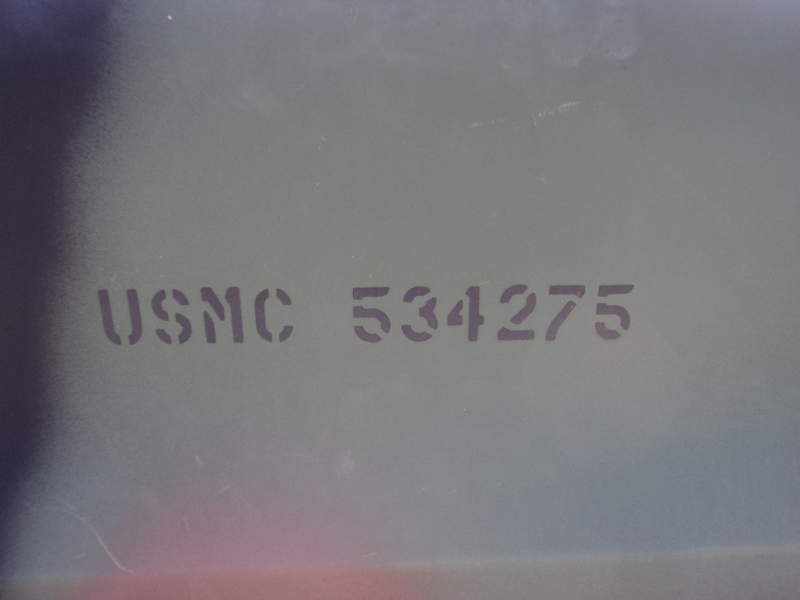

a) vin 1G8ED18J6FF162308
B) registration number 534326
c) nsn 2320011232665
D) location bought? Local guy says from Texas maybe
E) none visible
Sir, your truck was a Marine Corps truck as evidenced by the Registration number. I don't have access to the info. For what it's worth, my M1028FF truck is a Marine Corps truck with a USMC number of 534275 and it's a 1985 model. No bumper numbers on these, just door markings and tailgate markings centered that look like this.
