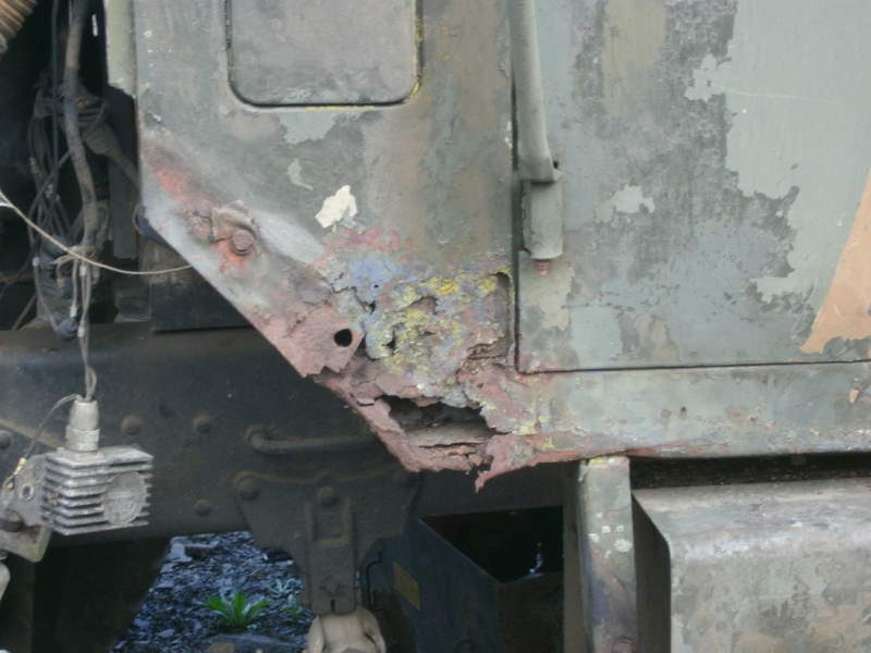

ok first is a shot of the roof , yes that is structural rust and it goes all the way around,

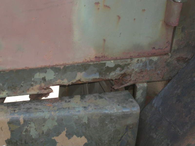

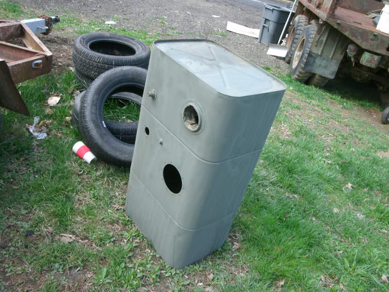

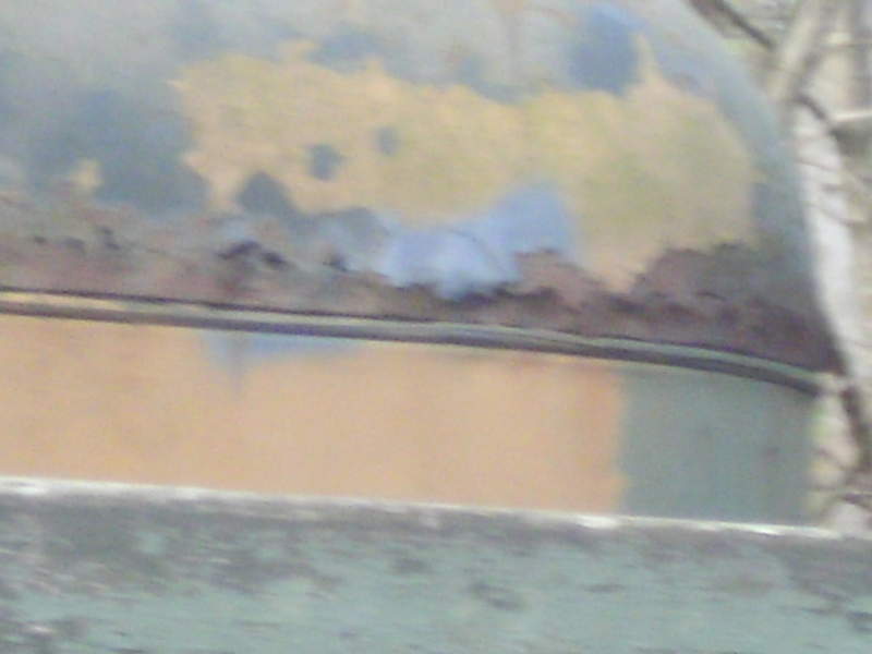

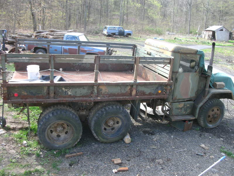

second is the fuel tank halfway painted, third is the back as of yet un painted, fourth is the drivers side front cab corner, nice little piece of sheet metal work to do ,aprox 4 hours , maybe 5 if my welder decides it wants to be difficult ,5 is the passenger side fender , it is just getting replaced , not even trying with it.pic 6 passenger side rocker pannel , going to replace the panel as soon as weather breaks. last pic im standing on the bed rails of an 87 chevy taking the shot
