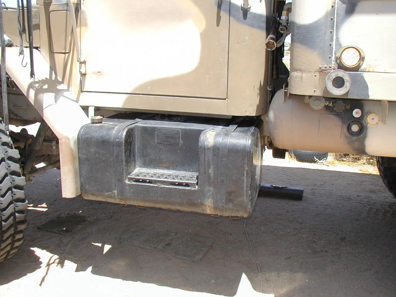

First the step-tank as mounted (noticed that I didn't have any posted that were post install)

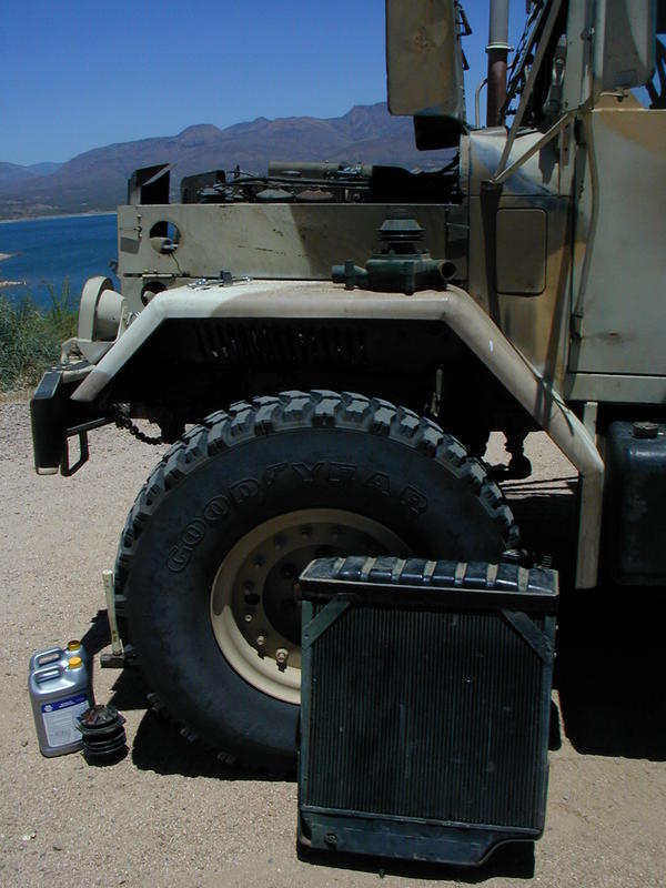

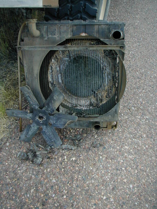

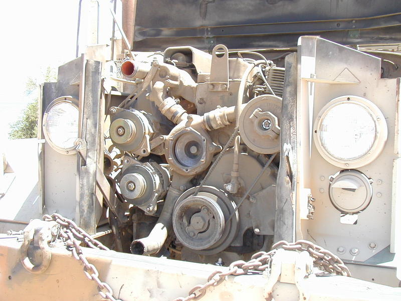

Then I took a roadside rest, on my `Zona Solo" trip, so that I could "upgrade" the Rad & Waterpump. Now She has a Rad that doesn't leak, and a Waterpump w/ bearings, . . . He!! of an "Upgrade" they work so much better now ;)

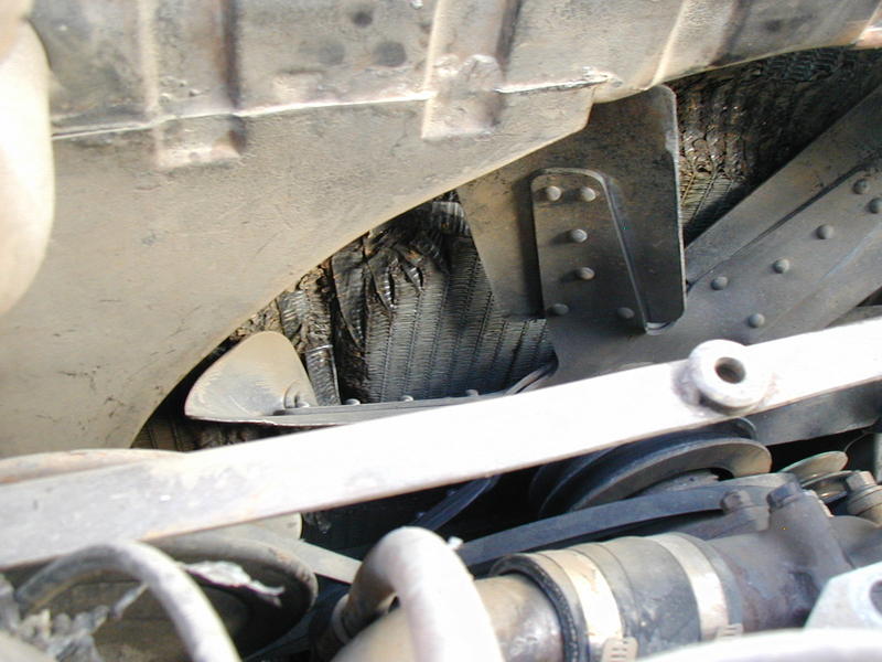

Hearing a drive-train paced thumping as vital fluids sprayed back onto the cab's view-port left me w/ a sick feeling.Once stopped I could tell that it was a gutted heat-exchanger, . . . the Rad was dumping the last of it's fluid on the ground.
Quick, I grabbed 5 gal off the rack and caught the last couple gals by opening the petcock. Never waste liquid out here in the dez.

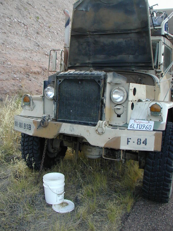

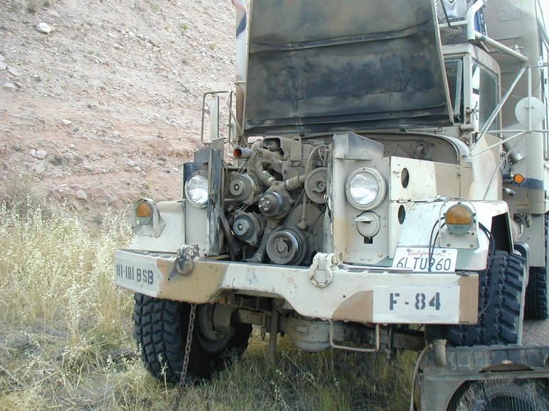

Waiting hours, till that burning day-star moved behind the ridge, I pulled the affected parts.

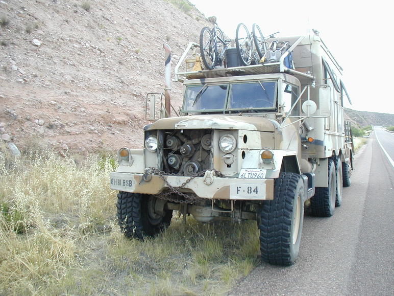

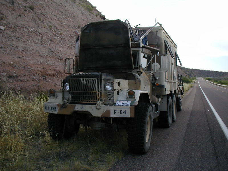

Now to move her, as short a distance as poss. I like to choose my "multi-day" breakdown spots ;)

Earlier in the day a sheriff had recommended the "No Camping" pull-off not that far behind me.
In front of me was a bridge, and no turn-around space on the far side . . . or as far as I could see . . . To either side of me were the walls of a DOT mini canyon, the kind that get made when they cut through a small ridge.
I scouted around a bit and figured I could turn her around not that far in front of me, right her in the mini canyon. Dodge some bigger ditch rocks, get one front wheel part way up the side, turn hard to the left . . . I THINK she'll make that w/o getting the back axles up . . . much.
Worst case I'll still be able to jack-knife the trailer a bit in a three-point turn :whistle:
She makes it! Hardly a challenge.
Now safely encamped above the lake, among the blooming saguaro, I install her upgrades (Thank you Castle Bravo!)
