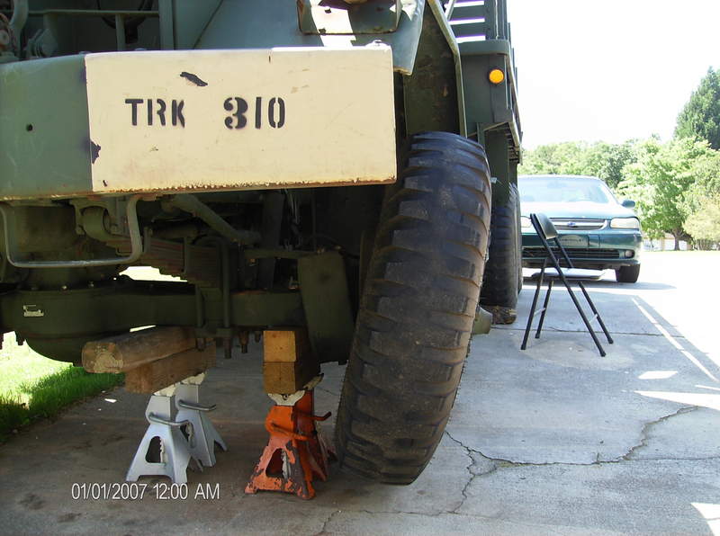

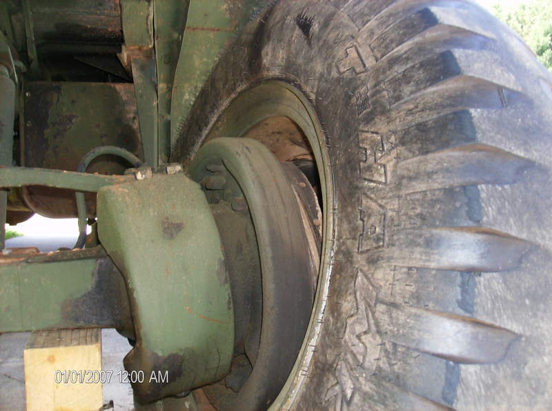

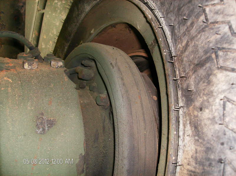

Looks like my front end is shot. I will not be able to attend any future events untill i get this fixed. I do have acouple of leads on parts and a few members helping me out. Thank you everybody for your support and hopefully i will see you in october..pics 212.jpgpics 211.jpgpics 210.jpg002.jpg003.jpg001.jpg004.jpg

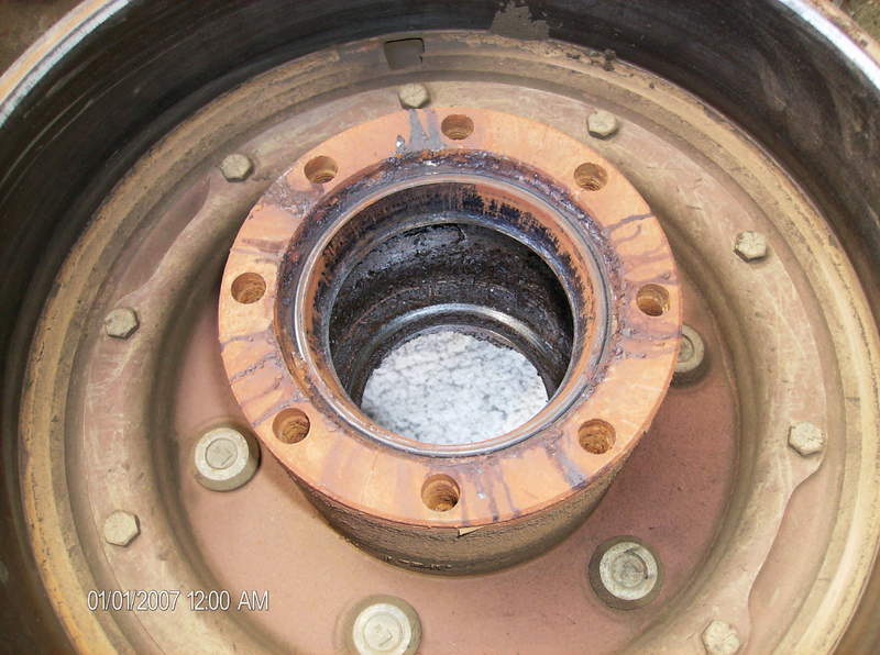

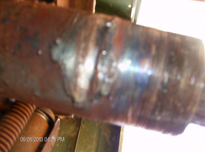

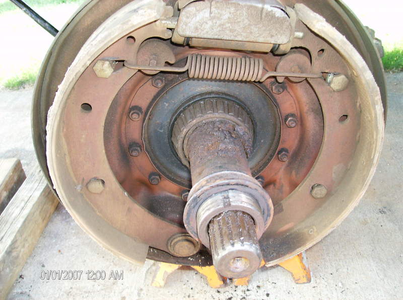

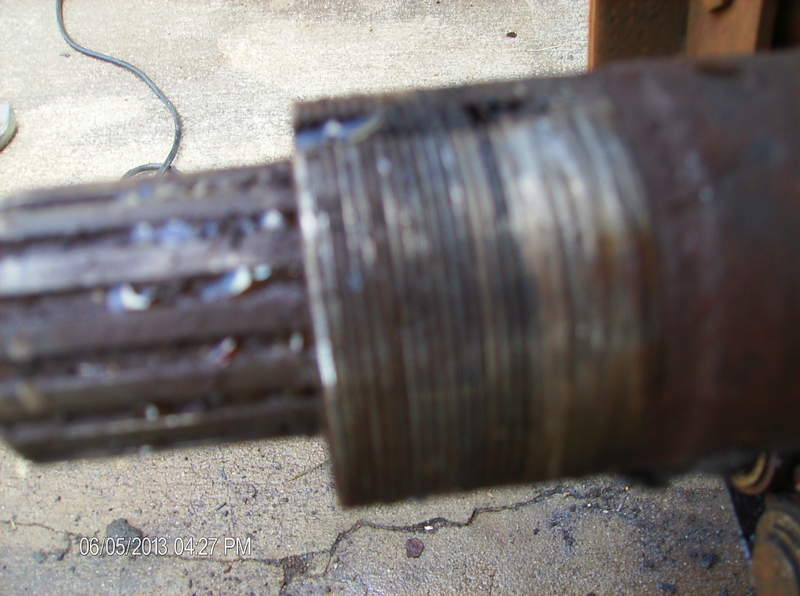

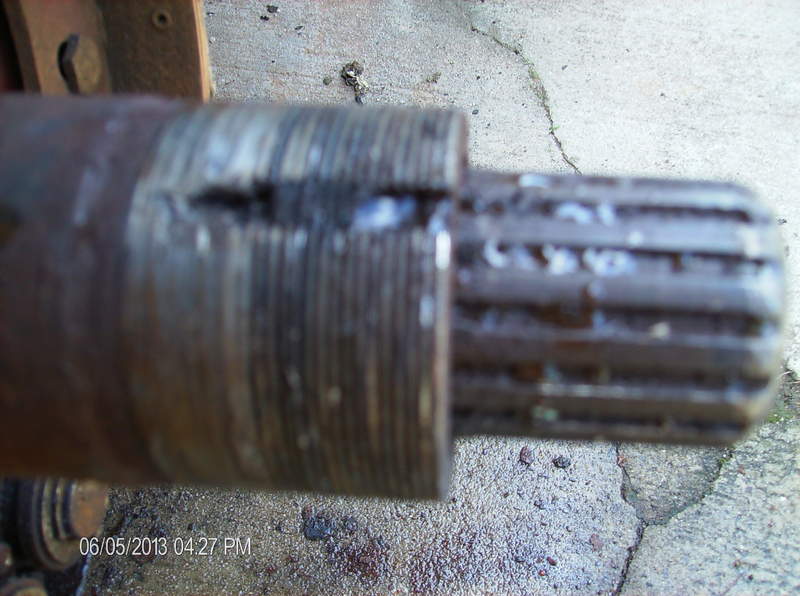

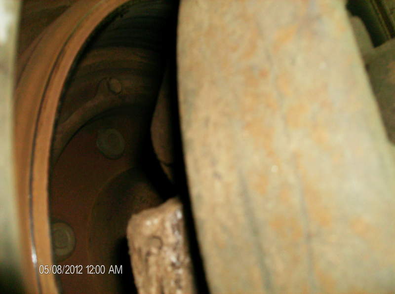

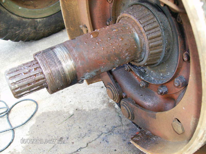

The front bearings was dry and the wheel nut possibly backed off. I havent had truck long so I havent went thru it. I will now. If wheel came off down the road it would of been a dangerous situation. So... outer bearing is ground down to nothing and spindle is scored alittle/ My plan now is get new inner and outer bearings, smooth the spindle and pack it full of grease. I think that will take care of that side. Once mobile i will take it to a friends where we will lube all the other wheels and bearings. Heres pics of damage done...HPIM0981.jpgHPIM0982.jpgHPIM0983.jpgHPIM0984.jpgHPIM0986.jpg

The day it broke i drove truck to store and it wobbled and had an intermentin noise. Then the brakes went out. I turned around and when i pulled in the yard smoke poured out of the wheel. The front tires were cupped when i got it so i figured the wobble come from that. It gave me small hints of something being wrong, I just wasnt listening.
