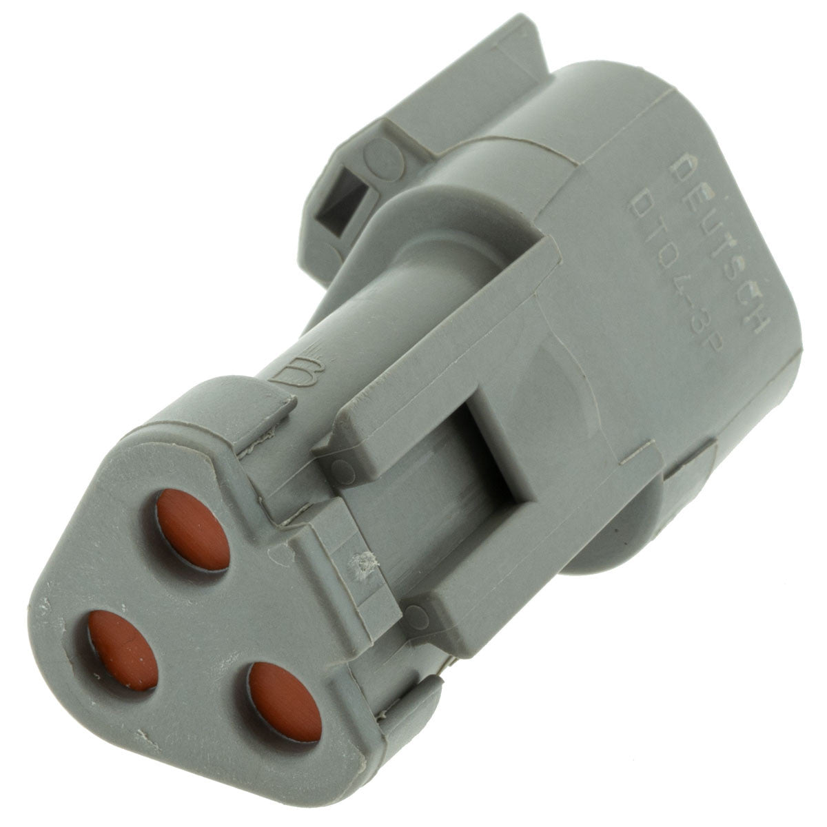

My CTIS has never worked since I bought my truck. Started messing with it and if I hit the CTIS box with a wrench it would start to work then quit. So I bought a new controller and installed it. It seems to work. I can hear valves opening every 15 seconds or so. After the 4th valve sound I started seeing smoke coming up from under the fuse panel. I shut the truck off let the smoke clear and started it back up. Same thing happen around the 4th air valve sound started seeing smoke. So I shut it down opened up the fuse panel so could see behind it and started it again to find where the smoke is coming from, this time it popped the CTIS fuse.

Sounds like the resistor in the J1939 circuit burned up, it lives under the PDP, there is another in the engine compartment near the engine ECM. We replaced our dead ECU with one from a M939. These CTIS ECU's conflict with those on the LMTV. Or it did on ours, burned up R12 and R13 until we 'adjusted the pins on the new CTIS ECU.
There is a thread here on the forum. It also affected our ABS circuit—

You can also just pull the pins out of the older controller that are responsible for burning out the resistors. They work fine and you can still communicate with them via J1708.
And you need two of these to replace your burnt J1939 resistors:

Which pin do you pull ? My resistor says DT04-3p the link you sent shows DT06 , are the other two resistors different?
Also only found 2 resistors one is by the motor ECU the other under the fuse panel, where is the 3rd?

According to @hike in this post:
You need to pull pins G, W, and X.
You should read through that entire thread. TONS of information there on the system wiring.
There are only two resistors - both 120 Ohm. When both are good you should see 60 Ohms between J1939 + (high) and J1939 - (low).
Ah yeah - I linked to the wrong one. You need this one:
I'll edit the previous post.
