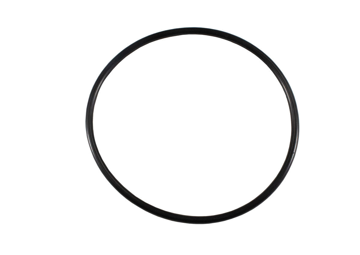

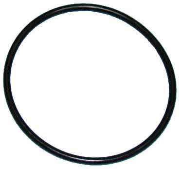

Good call on the o-rings, I completely forgot about those on mine and will have to get a set too. Are either of these the right ones?
Not quite sure yet.
Looks like a -239 o-ring.
I personally wouldn't purchase either of these. It looks like the top one would work, but without the specs I wouldn't purchase. The groove in the cap tells me that its a AS568 -239 o-ring. I'm going to pick up a few of them from a local supplier here in Norfolk, VA. $1.89 each.
Talked to Norm at Chesapeake Bay Rubber & Gasket and he hooked me up with three -239 o-rings free of charge and they fit perfect!
