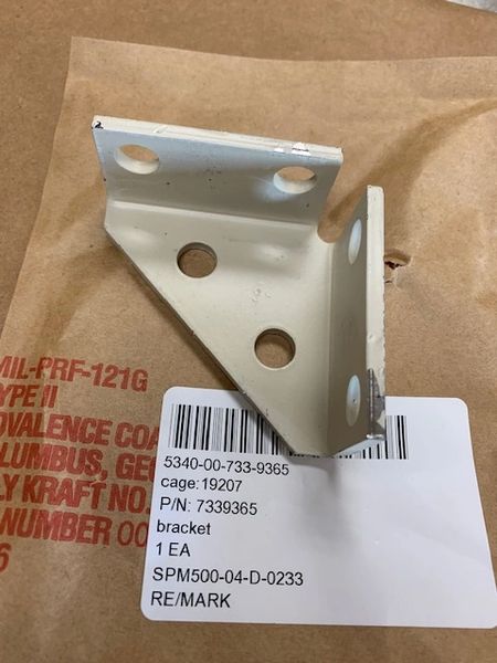

Received them today. Can’t complain about anything. Great service and great communication. Looks to be an exact duplicate to me. My only concern is the fact that mine bent were the stick out from the frame. I might build a dolt on support brace. Now I need tub brackets and how it attaches to the frame and a front leg. I have a line on a parts trailer with all that but it’s $300 I can’t spare right now.
xjghost
45
53
Camden, SC
So got it home. Now I have a front gear and 2 more rims. I need to source some good tires. 9R16’s are pricey. Is there any 16” that is a skinny 35” other than Boggers? P-metric?
Also gives me some brackets needed and shows me how the two mate. Hopefully next weekend I can get back at it.
