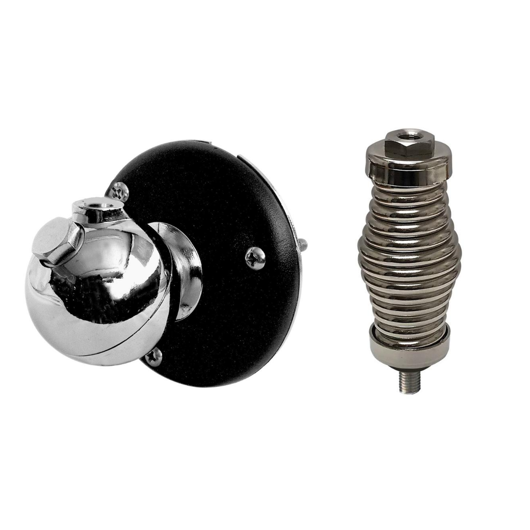

I needz dat antenna !
Antenna itself (there are different colors to choose from):
Mount:
I originally got a 9' whip antenna but that ended up way too far into the trees. This brings it down so it's not hitting trees, stoplights, or power lines (just kidding), but the larger size increases the aero drag and bends it back a bit. I need to somehow secure it upright but haven't solved that problem yet.
